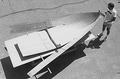

Stitch 'N' Glue Boatbuilding
Our new boat went together pretty fast – “instant boat” (i.e. Stitch & Glue) construction. What kind of a paint schedule can you use to get it in the water next weekend? Let's say the inside will be all one color and the outside all one color, not necessarily the same as the inside. You can do the outside in one day, the inside the next, and give it a couple of days before you launch it. Here is the schedule. Sand it all over with 60 grit sandpaper and clean up the dust. Put on a coat of latex primer. That will raise some hairy fuzz, so after drying a couple of hours give it a once over with 60 grit to defuzz it. Put on a coat of your exterior latex paint. Gloss is the toughest and most durable, but also shows surface imperfections best. Semi gloss is almost as tough, durable, and easy to clean as gloss while not showing surface imperfections. For me, it is the usual pick. I have stayed away from flat paint.
You won't have to sand after the first coat of finish paint and you can easily recoat in the afternoon. That finishes half of the boat. The next morning turn it over and repeat the schedule for the other half of the boat.
If you use two colors on the outside of the boat, you will add another day to the painting. If you use different colors for the bottom and the side on the inside and have a steady enough hand to cut it in at the chine you can do it in one day.
While it is best to wait a week for the paint to dry hard, don't let it keep you from getting in the water before next weekend.
