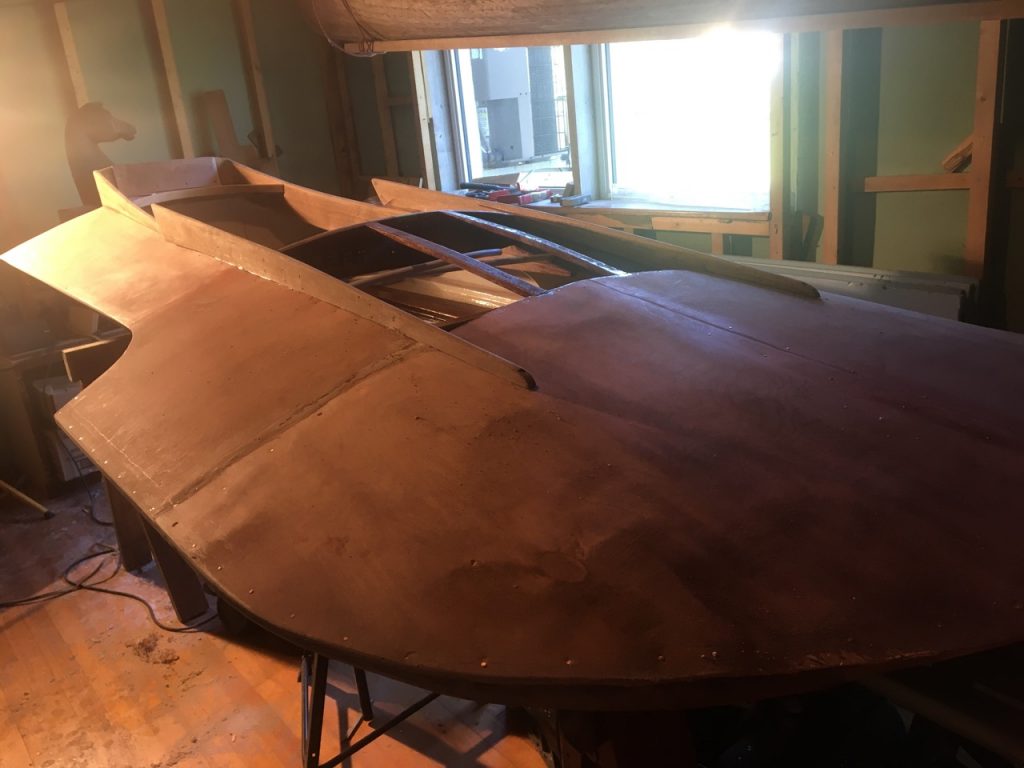

Closing down the deck
You are probably going to notice a few modifications with this build. The double wing cockpit combing for example, not exactly stock. But since I'm leaning towards a steam punk style of vessel I started thinking "Bat Mobile".
Can you notice any other modifications? I finished the interior of the hull before putting on the deck. Notice the out of reach areas are painted a creamy white and the cockpit floor has been epoxied, and Varnished, I added a bunch of brass sparkle dust to the varnish. Shine on you crazy diamond.
