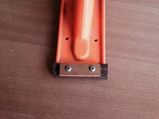

Adhesive paper of the size needed for these boards only comes in rolls, and not a large selection of grits. But belt sandpaper is much easier to come by and 3 x 18 or 21 is a perfect fit. Below is a picture of how to use a sander belt on this board. Screws into the plastic hold fine. This allowed me to use 50 grit, which is unavailable in a roll (and in any case, who needs a huge roll of 50 grit?).

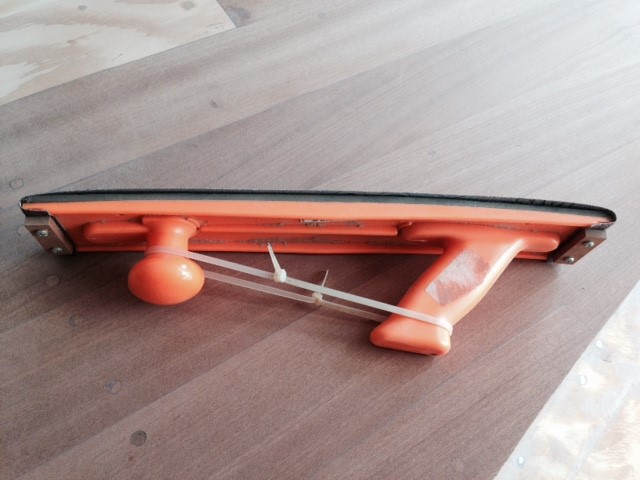

I think a difference between this and what others have used is the loop over the handles. Although the board is flexible, if you use it as-is and just let it bend, it’s harder to push and you get heavier sanding at the ends. The loop pre-flexes it. In addition, it's fairly easy to pinch the loop with your fingers, adding more of a curve when needed. I wasn’t thinking of it being a flexible board as much as a curved board with a variable curve.
