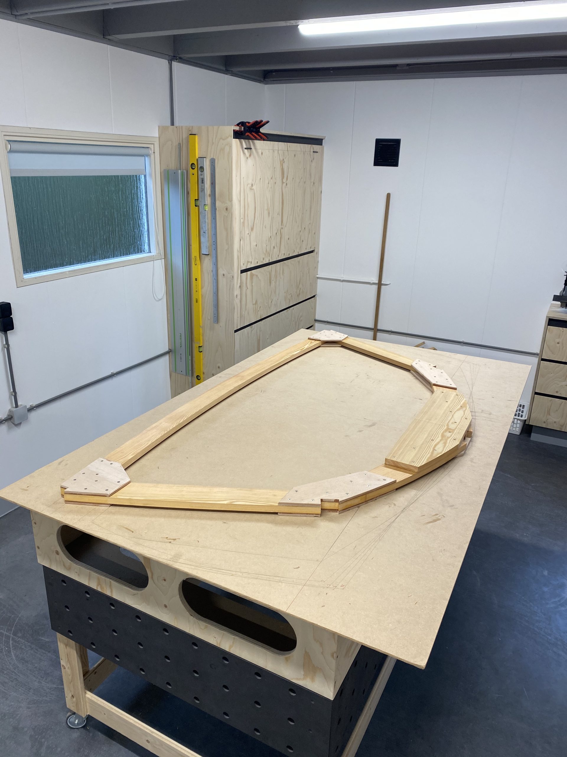

I just finished my first frame (no.5) constructed out of Siberian Larch and okume plywood.

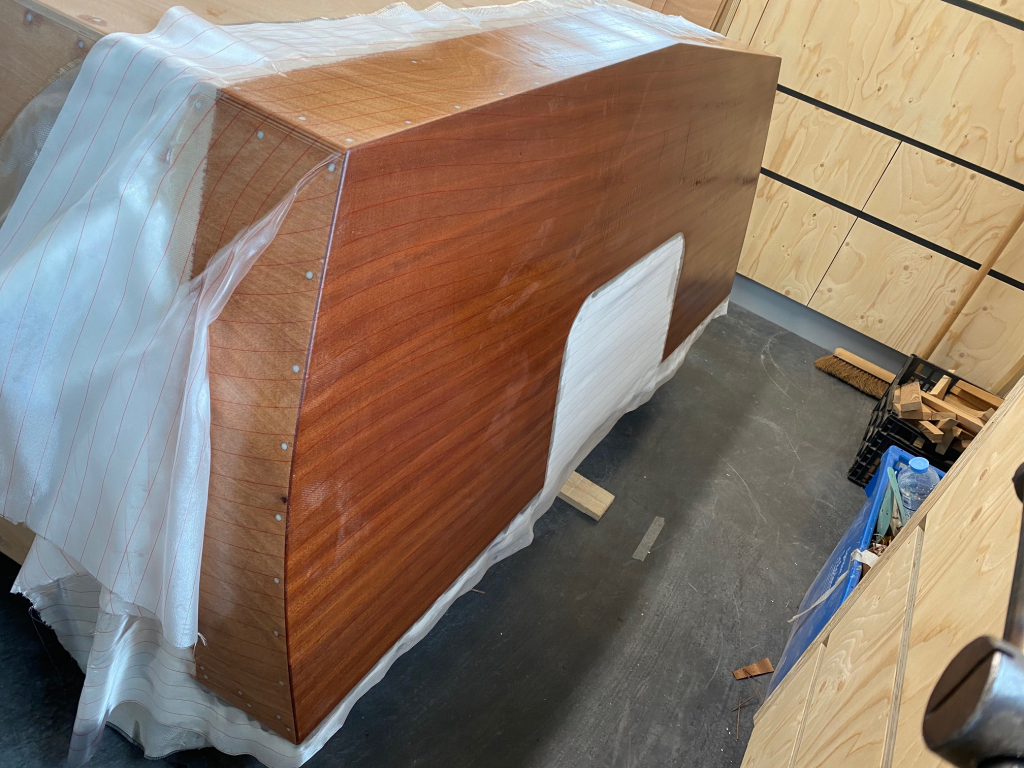

so last minute before glassing up the hull I decided to epoxy glue mahogany veneer on the transom, was playing with the idea earlier but let it go because of all the extra work, but as this has to be a multi-generational boat I thought I shouldn't be cutting corners and make it awesome, or at least try..
I found the glassing process to be quite hard to be honest, I started with the transom and made use of peel ply, as I like to do these (pretty much everything) kind of things on my own I skipped the peel ply process after the transom, It is just to much work to do on your own. and sanding her up after the epoxy cured took me only a couple of hours.

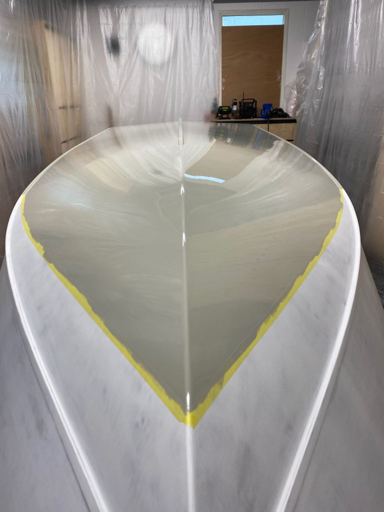

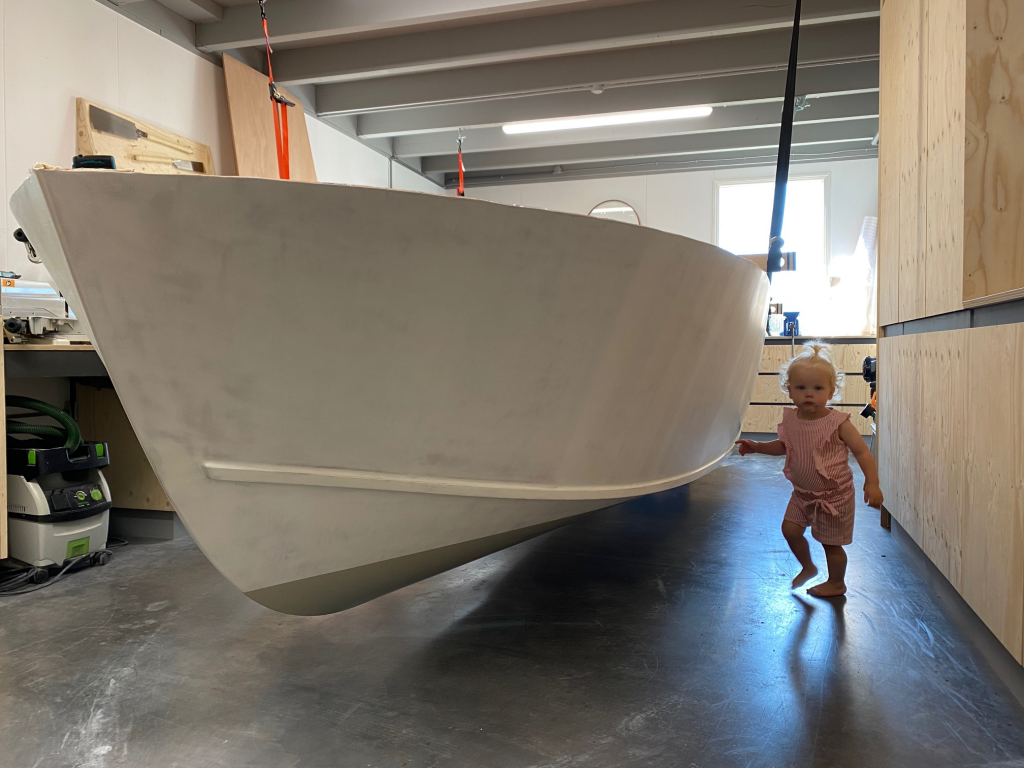

Decided what the final color should be, honestly there are so many colors what I could like, but I eventually just picked one, The whole hull is going to be painted in RAL 7032 (pebblegrey) with a cream white waterline mark.
I painted the bottom (under waterline) 3 times the roller and tipped it. looks quite clean, still some dust even after wetting the floor etc, but it is acceptable, especially for under the waterline. As I will keep the boat on the trailer I figured I wouldn't need a anti fouling coat or somesort.

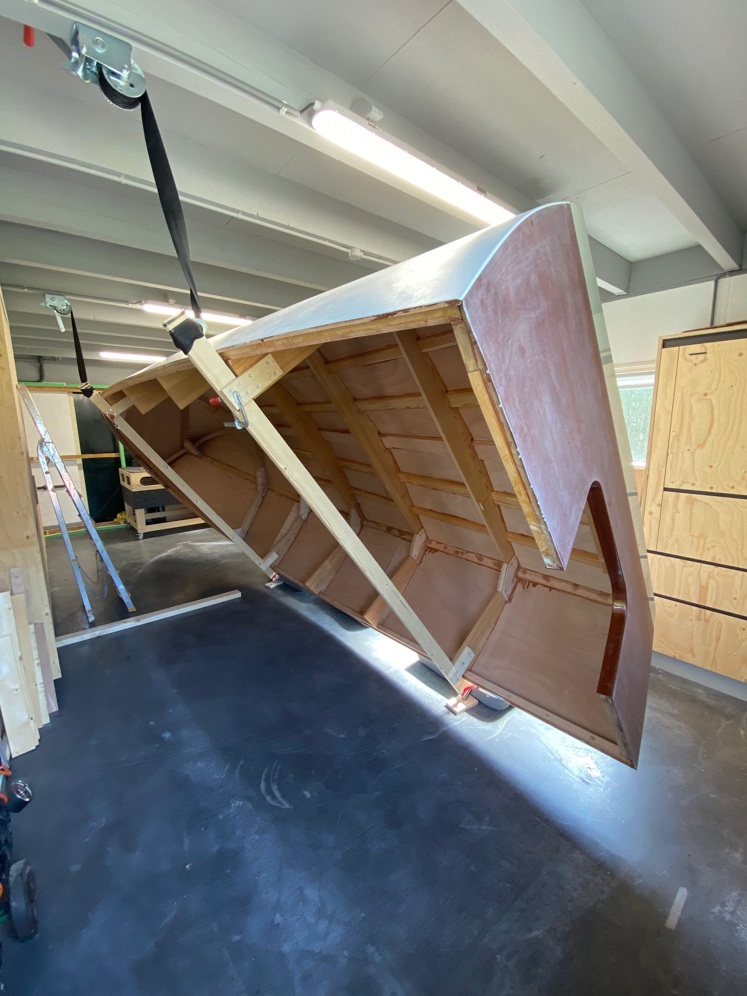

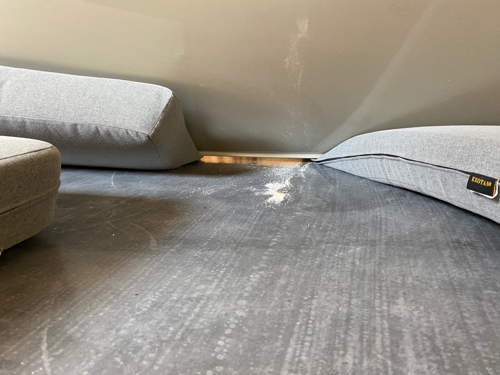

So after this stage It was time to flip the hull, as it didn't make much sense to paint the rest of the hull at this stage as the deck still needed to be mounted and the potential of damages etc during the next fase.
Silly me decided to flip this thing on my own, I wouldn't necessarily advice to do this on your own but it is part of this personal challenge for me, I want to do as much as I can by myself, total control and when the boat is finished I need to have peace with all my own actions. Not sure if this makes any sense but it does for me anyway.
It goes without saying that this is such a great moment during this built, I feel great, the feeling of accomplishment and realisation that you have built an actual boat, (unfinished but still) is amazing.
Next up cleaning up the insides of excess epoxy, making fillets and preparation and investigations of the equipment which will have to be integrated, exciting stuff!
