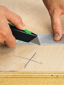

Of course, because it’s composed of very thin layers with their grain crossing each other perpendicularly, it can splinter when you are cutting it. This is called “tearout.”
One way to avoid this splintering or tearout is to run a sharp utility knife along a straight edge (where possible) to score your cutting line. If you do this before getting out your saw, your edges are much less likely to splinter and you should get a smooth, clean cut.
Try this method and see how it works for you, then leave your feedback to share with our other readers.
