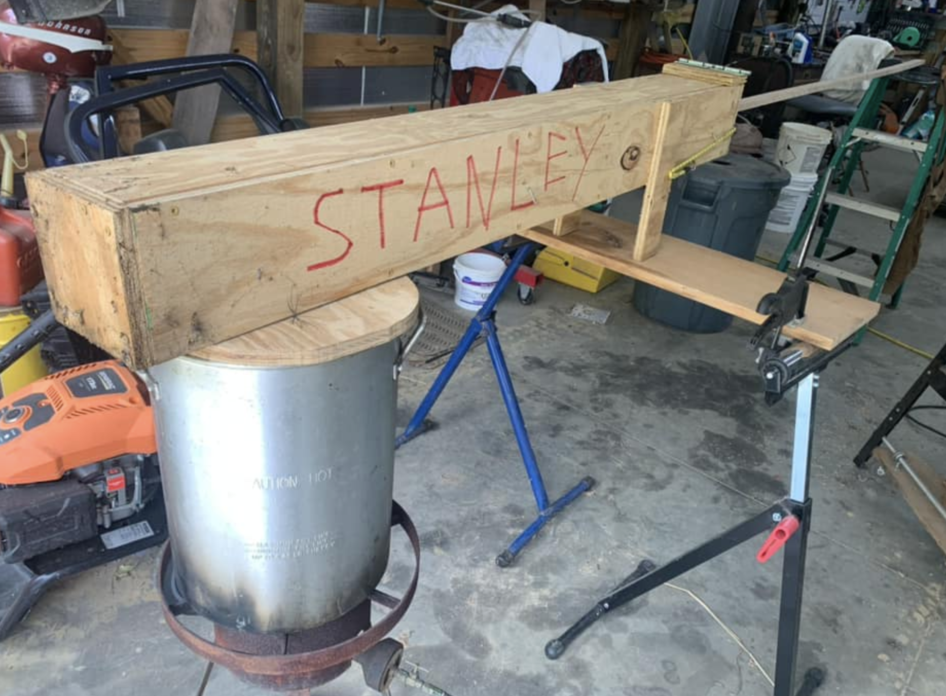

• Why is steam bending out of the question? I made one very simply out of 4" PVC pipe, some rad hose, a kettle and a camp stove.

• I made a simple steamer. The white oak bends like a rubber band.
