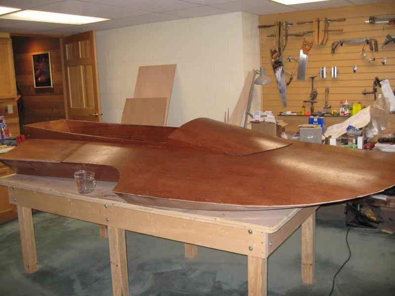

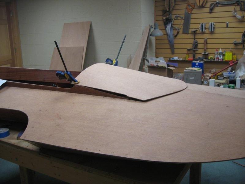

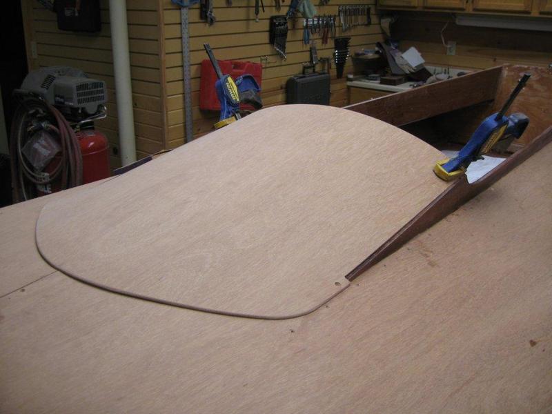

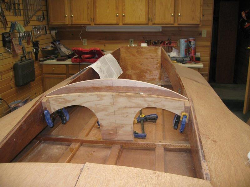

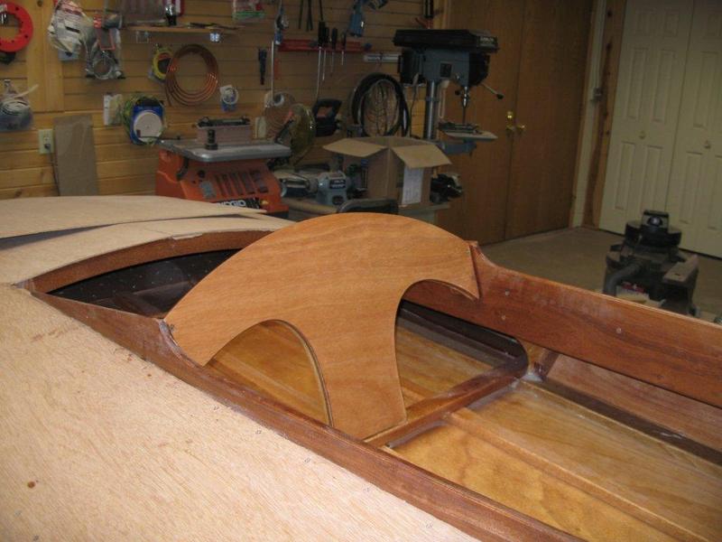

This week I've been working on the dash and cowl. I laminated some Okoume to the DF dash that came in the frame kit to give it a little nicer appearance and I also wanted to make the curve of the cowl a little higher (personal aesthetics). Once the lamination cured, I used a router and trim bit to trim the Okoume to the DF dash. I reshaped the dash to allow easier access with legs because I know the Gran Kids will be sitting with their legs forward into the bow and I want to make sure that they don't get stuck in there should they flip this thing. I made some blocks to mount the dash to the coamings. The bottom of the dash will be doweled into the crossmember on frame 2.
I had to use my Dremel with a cutoff wheel to cut and shape the Meranti cowl. It just shreads horribly so the cutoff wheel and sanding seems to be the best for all the shaping necessary to get a good fit. Today the dash was installed and encapsulated. Tomorrow I will finish fitting the cowl.
Wednesday, February 22, 2012

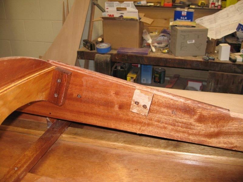

Today I finished fitting the cowl and attached it as well as finishing the first coat of epoxy overall. I made some small attachment blocks to make sure the sides of the cowl along the coaming sat down and didn't bulge up. The edges sit in that rabbet groove in the coaming. Tomorrow I will shape and sand the rest of the cowl and start filling in screw holes and other imperfections. The only construction left now is the transom knee.

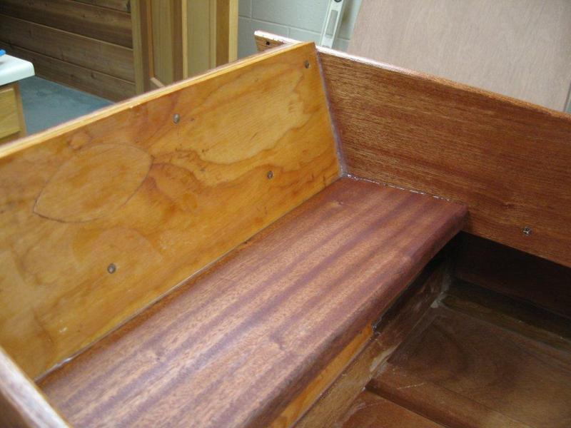

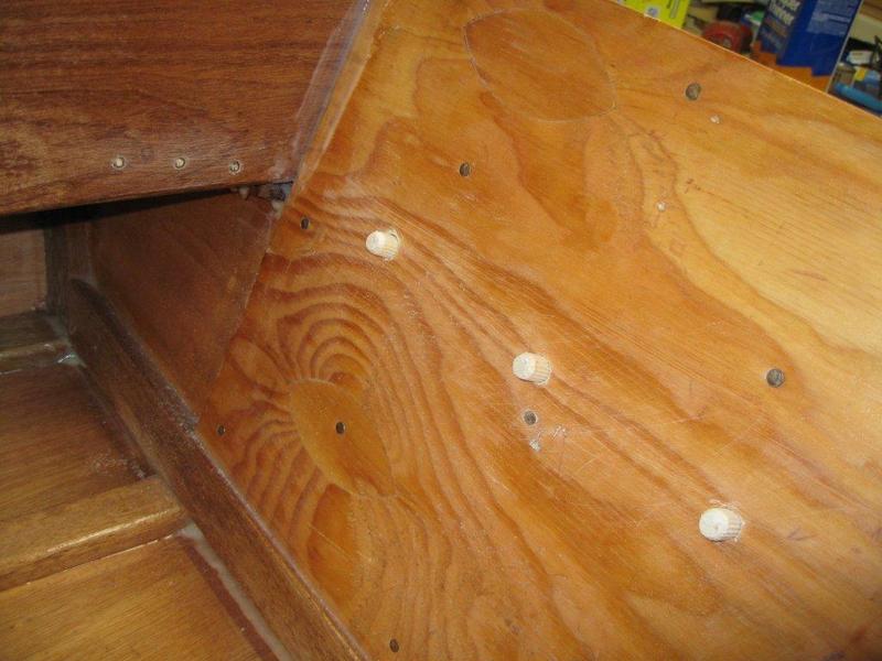

After a few days of putzing (yah, I do that) I installed the transom knee in the Spartan. The knee is just a plank that runs athwartship from coaming to coaming and butts up against the transom. When I installed the aft deck planking I knew I would be boxing in the sides and make using screws difficult, so I decided to dowel pin the knee in place. Half inch dowels secure the rear to the transom and 5/16" dowels secure the sides. The holes in the knee were well packed with thickened epoxy. The transom pins were set in place with glue in the transom and the side pins were packed with glue and slid into the holes in the coamings. Copious amounts of glue was applyed to all mating surfaces (and other things). Once the knee was set in and tapped into place against the transom, I was able to reach under and tap the side pins into the knee. Everything locked nicely onto place.This completes the construction phase of the Super Spartan. Now it is on to sanding and shaping areas, filling in and fairing where needed, and start the finish work and rigging.
- Dowel placement in the transom and coamings. The dowels in the coaming will be packed in glue and slid flush so the knee can be set on the transom dowel pins. Once the knee is set, the pins in the coamings will be driven into the knee to lock everything in.

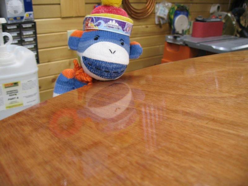

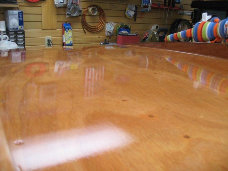

I finished the "varnishing" of the Super Spartan bottom last night. I used the System Three WR-LPU Clear Gloss using 4" foam hot dog rollers. I have 5 thin coats over System Three General Purpose Resin. I allowed the resin to cure for several weeks before sanding. Each coat of resin was applied in thin coats using the same foam rollers purchased from HD. The resulting finish with the resin was nearly as good as the finish I achieved with the WR-LPU and I also did no tipping on the epoxy resin. After allowing to cure and completely gas out, the resin was wiped down with warm water to remove any traces of blush (I actually did not see any, but wiped the surface anyway). The surface was sanded with my 6" random orbit air sander using 220 grit discs. The surface was then cleaned using DuPont Final Kleen 3901S prior to applying the clear gloss WR-LPU.The humidity was about 45-50% in my shop and I thinned the material 10%. I kept a wet edge, did no tipping other than remove some foam where the roller oozed some out on sharp corners, and refrained from over working the material once it was down. This paint is very sensitive to overworking. Once it is down it needs to be left alone to allow itself to shed any tiny bubbles and level itself. Tipping does not seem to be required if thin coats are laid down in a higher humidity environment.I am very happy with the results and will continue to use this product. It does not smell, is water clean up, water reduced and, once I learned how to use it, produces a very nice, durable, high gloss finish without the problems associated with spraying. Several coats can be applied in a day and no sanding required between coats if applied within 24 hrs. I did not sand or buff between coats and this finish was acheived with 5 coats applied over two days. I will let it cure for several weeks and then buff and wax the surface before righting the boat for the deck finishing.
