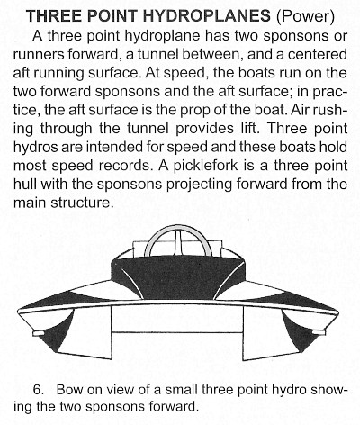

The sponsons at speed are planing on their aft end; they are not going through the water but they are skimming over the top, supported and lifted by the air rushing through the tunnel between the sponsons.
The third point at the transom should also ride loosely on the water, and in racing hydros the prop is virtually supporting the aft end.

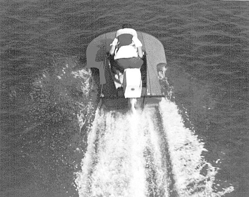

Our Tiny Titan test model was built per the plans and weighed 74 pounds. Powered by a 14-HP outboard turning a two-blade 7 ½ x 10 prop, a calibrated speedometer registered 33 mph with 5 gallons of gas and a 175 lb. driver aboard.
Your solution to your spray problem may work to your satisfaction, but as the designer and test driver of the prototype I know it shouldn’t be necessary. I had a lot of fun with the little hydro and as shown in the photo there was minimal spray from the sponsons at speed.
