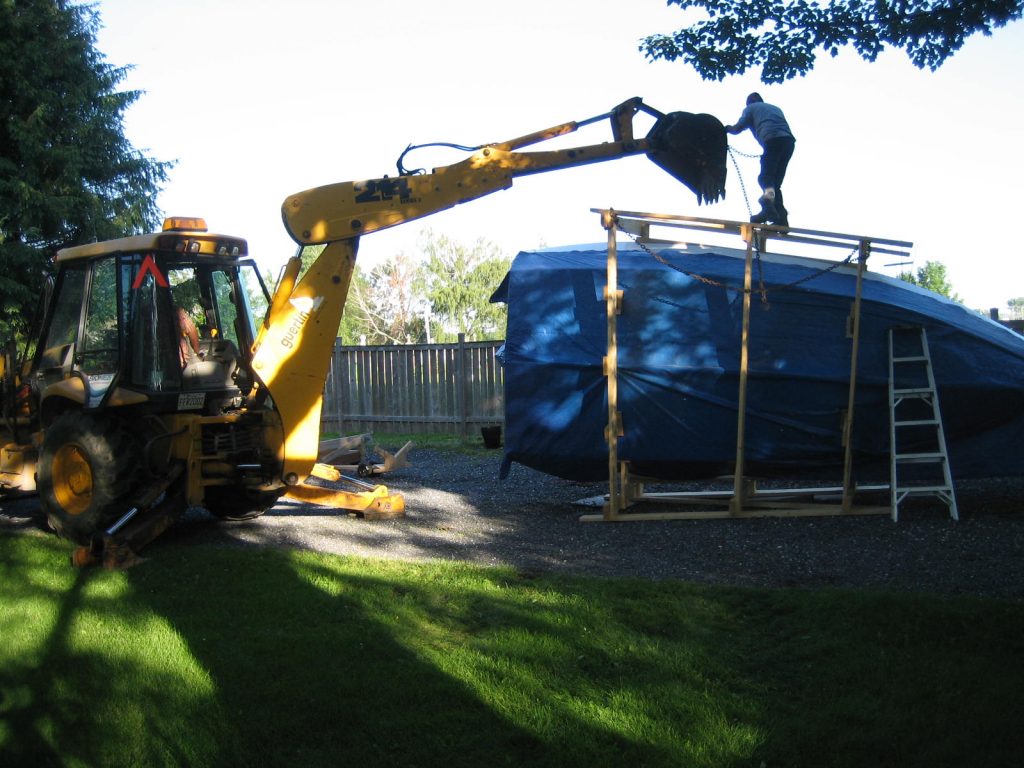

Turning the hull right side up is a job for professionals with proper equipment (backhoe, crane or similar) and an operator with a gentle touch on the controls. Unless you are in the lifting or construction business yourself, I strongly suggest that you watch from afar, and let the professionals handle the job. Plan on having the job done on 2 separate days, as there is much to do between day 1 and day 2. There will be plenty of prep work for you to do as well. Identify or assign a lift manager and have him/her inspect and approve the crate and arrangements a day or so before the equipment/operator arrives. If he/she suggests modifications, do them and get approval before the equipment is scheduled. This is extremely important, as a clear line of responsibility must be maintained.

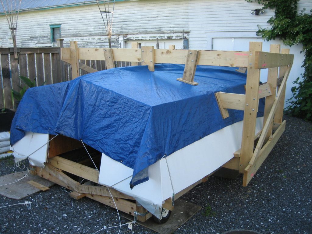

Build a frame around the hull with construction lumber. You will need at least 3, 2 x6 x 10’, 10, 2 x 8 x 10’and 3, 2 x 4 10’. Also, you will need about 50, 5/16th x 6’’ lag screws, and a box of 100 5/16th x 3 ½’’ carriage bolts. You will use about 60 to 70 on the job. Also, a 2 lb box of 5/16th washers used with both lag bolts and carriage bolts. For tools, get a good quality percussion nut driver. I use a 20V DeWalt with a 6-pan high quality socket.
Install 3 2 x 8 x 10’s on edge under the boat and attach them to the three 2 x 6’s you installed before turning the boat over. Use lag bolts and filler blocks if necessary to make a solid attachment. The cage assembly should be somewhat aft of the midpoint, as the hull is heavier aft. Discuss this with your lifting crew before starting. Screw the shaped pieces that you removed at ** in ‘Turning the Hull (1) to the chine with substantial screws, 2 ½ x #10, to give a reasonably square surface to the ground. I call these trim pieces. Yes, you will have to fill the holes after, but they will be under the sheer hooks.

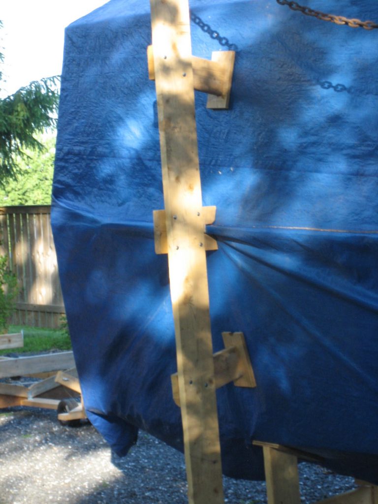

Cut the 2 x 6’s in half and attach them square to the 2 x 8’s, in contact with the trim piece, with 3 carriage bolts . This works best in a triangular pattern, 2 inboard, 1 outboard. The end of the upright should be flush with the bottom of the 2 x 8.
Trim the 2 x 8’s flush to the 2 x 6’s and make sure the 3 ends of the 2 x 8’s are in a straight line. Attach a 2 x 8 board across the ends of the 2 x 8’s with 2 lag screws in the 2 x 8 and 2 lag screws in the 2 x 6 vertical. Do not skimp on lag bolts or you will have a safety issue and a collapsed boat later on. Do the same on the other side.
Next, fit 3, 2 x 8’s across the top and secure them to the 2 x 6’s as described for the bottom. Start one end flush to the upright and trim the other end flush to the upright on opposite side. It is important that the top 2 x 8’s be in a straight line. so use uprights of equal length fore and aft and establish the height of the center beam with builder’s line. Attach a 2 x 8 to the uprights and ends of the beams as you did for the bottom. Cross brace the assembly with a 2 x 4 screwed to the transverse and bolted to the verticals. These bolts can be 5/16th x 4’’ Similarly, cross brace the 3 2 x 8’s on the top with a 2 x 4 that is securely bolted into the 2 x 8’s that traverse the hull and the longitudinal 2 x 8 that connects the 3 transverses. It is extremely important to fit this brace correctly with a good-sized triangle at the ends between the longitudinal and the transverse.
Cut and fit a keel support for the aft transverse and bolt it to the transverse with 4 carriage bolts. Likewise, make 9, 8’ ’x 10’’ pads and attach them to the ends of 2x stock (2 x 6 or 2 x 8) with substantial screws countersunk so as not to damage the hull. Six will be attached to the top frame transverses, half way between the chine and the keel, and three will be attached to the upright 2 x 6’s on the side to which the hull will be turned at a position closer to the chine than the sheer about two thirds of the way. Use at least three carriage bolts on each joint and make sure the braces are snug and flat on the hull. All transverse and upright pieces should be trimmed to have flush ends. Be aware that the frame is square in profile, but narrower in the front than the back in plan. This has implications for the lift.

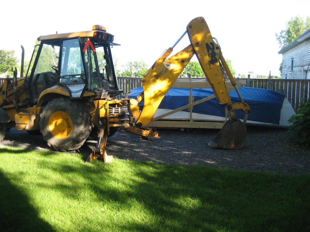

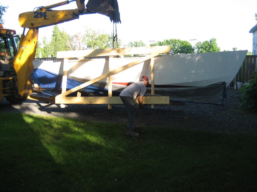

The lift manager must inspect the cage and bracing before starting the lift. If adjustments are required, do them. He/she (the lift manager) will attach cables, ropes or chains to the far side longitudinal and lift which will cause the crate to turn on its side. At this point the lift manager may or may not relocate the cables etc. and finish the lift by turning the hull the remaining 90° so it is now resting on its support transverses, sheer side up. As it is expensive to have equipment on stand-by, it is better to dismiss the crew while you prep the next part of the job.
Now, prep the cradle. Remove the 2 x 6 cross pieces you installed to support the inverted hull. If you have wheels, align and tighten the axles. Install carpet on all frame parts that will be in contact with the hull. If the boat must be put into a shed or garage, line up the cradle with the door. Dismantle the crate around the hull leaving it (the hull) resting on the 3 2 x 8’s with the longitudinals still attached. The lift manager will need at least 2, 30 ft lifting slings, which he will fit between the keel and the remains of the crate. As the slings reach the sheer, be prepared to insert a transverse 2 x 6 or 2 x 8 inside the hull to support the inward pressure created by the lift. The lift manager will advise. The lift should be straightforward. Pick up the hull and lay it gently in the cradle. Retrieve the slings and if necessary, get the crew to help you put the boat in the shed or garage. Push the cradle, not the hull.
Note: One thing I did not do but that must be done to ensure a safe operation is to diagonally brace the top of the crate before the lift. This is essential as the crate can collapse otherwise. It is not possible to diagonally brace the underside.
