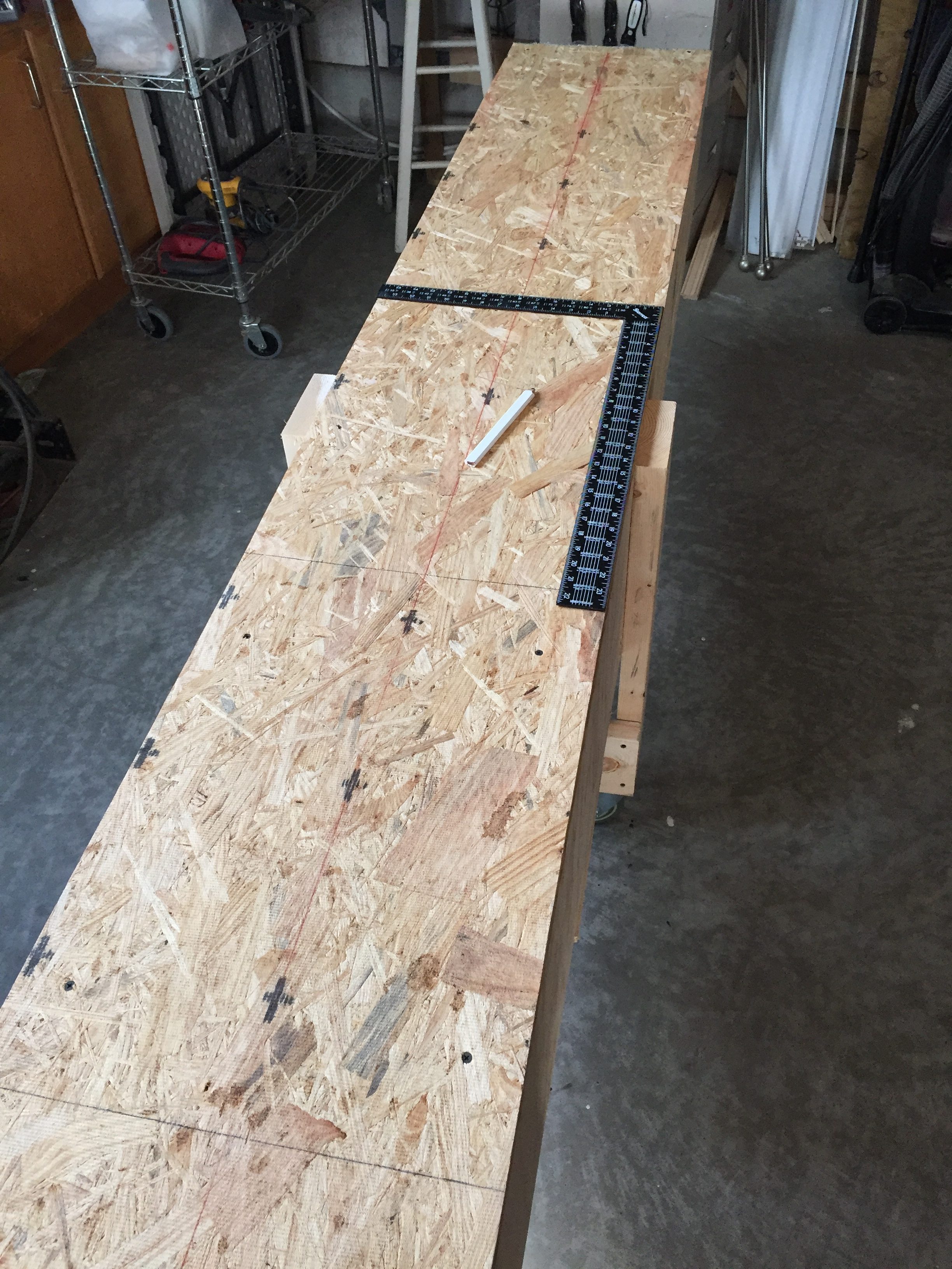

I built the strong back with 1/2" x 4' x 8' sheets of plywood, cut them and nailed them to a 2 x 2 frame and once I had a 16 foot long box I added some legs and casters so I could move it around to work on it. If you have the room it would be preferable to have it permanently set up so you could shim the legs perfectly level. I do not have the room but fortunately my garage floor is very flat so it wasn't a problem for me to make it mobile!
As you can see above I've marked a straight centerline by snapping a chalk line lengthwise and then used a carpenter's square to mark perpendicular lines spaced according to the plans. Each perpendicular line represents a spot where one of the molds will be attached.
You might be wondering how I'm going to build a 17' boat on a 16' table? I don't have room to work around a 17' boat so I'm going to proportionately shorten the spacing of the molds so I'll end up with a 16 foot Whitehall. Hull speed in knots is calculated by taking the square root of the length of the waterline times 1.34 so I'll be losing very little speed through the water.

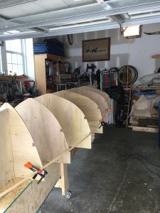

Part 3: Making the Molds
More plywood! The plans come with full size drawings of all the molds for each station from stem to stern. (The stem is the front and the stern is the back of the boat where something called a transom will be built and mounted later.)
Now, how do you transfer the drawing to a piece of plywood to cut the molds? Believe it or not you can still buy carbon paper at the big stationery stores so I purchased a package of 50 sheets for less than $5 and put those down on the plywood then with the drawing on top I carefully traced over the lines using a gel pen so it would glide smoothly.
When I lifted the drawing and carbons I had a perfect transfer to the wood and cut along the line with the little jigsaw above. I left a very small amount of wood over the line and then sanded back to it so I'd end up with a smooth surface.
After cutting and sanding each mold you will have one half of the complete mold station so you will need to flip it over and trace along your mold ( the half you just made) and repeat the process until you have both halves of each mold for all the stations.
Since the strip planking will eventually fit tightly to the molds it will be necessary to partially destroy them to get the boat free. This can be facilitated by butting together your two halves and attaching them to a smaller square of plywood with a few screws so you can pull each half out separately later.
In the picture above you will see that I have attached all of the molds to the strong back and I mocked up a strip of wood to get an idea of the shape of the boat.
At this stage it's very important to make sure all of the molds are lined up square and plumb to the strong back to help make constructing the boat easier.
It was so much fun to see something already! This was on my third day.

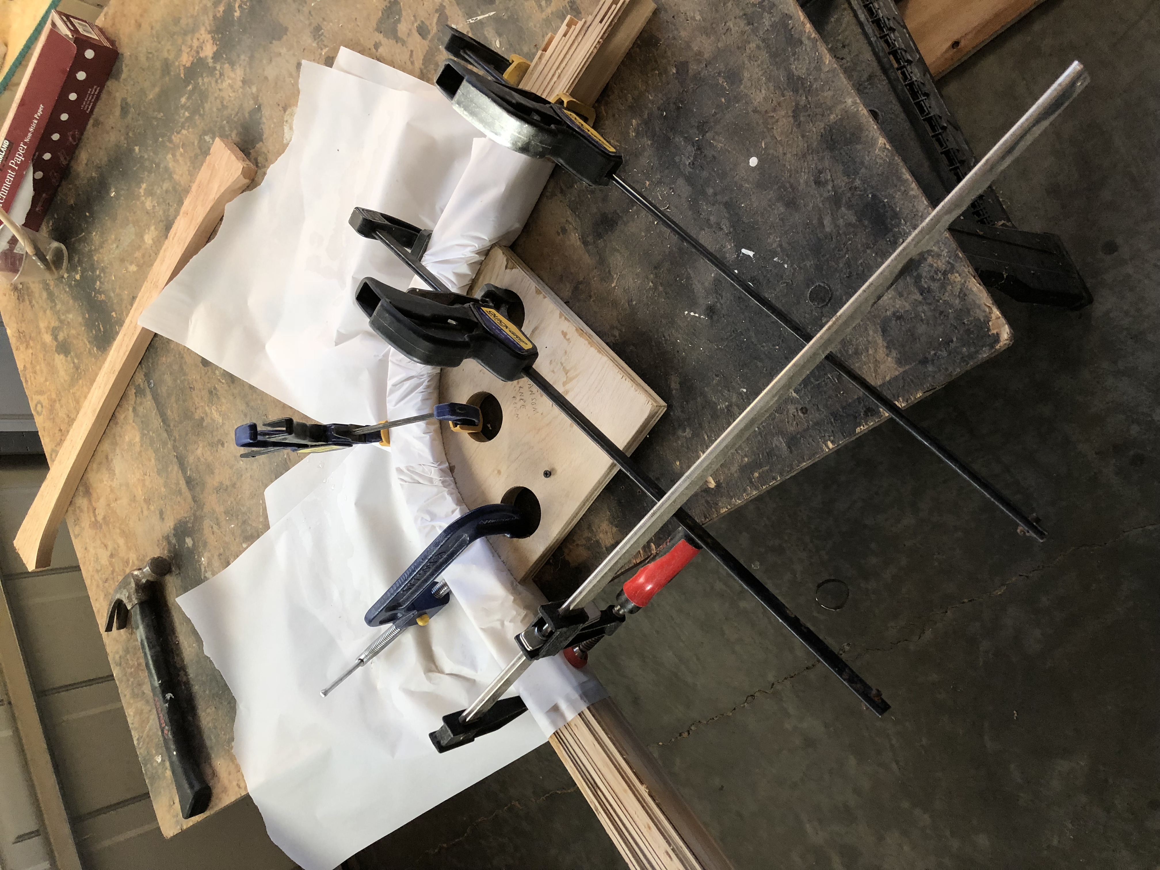

The stem is the continuation of the keel which will be about 3 1/2" deep so how do you make a two by four piece of wood curve up from the keel? You do this by using glue to laminate enough thin strips of wood until you have a stack about four inches high then you bend them around the form and clamp them in place until it sets up.
My stem was laminated using clear epoxy which was then wrapped in ordinary parchment paper. Parchment paper is that stuff people use on a baking sheet to keep cookies from sticking to it and guess what?- Nothing sticks to parchment paper, not even epoxy glue!!
After the stem had cured I unwrapped it and attached it to the mold.
Here is a photo of the laminated strips of wood that were easily bent around the stem form but after curing could probably hold up the house! It's difficult to see traced lines but the stem needs to be made larger than the final finished part so the proper contours can be cut later. The stem needs to be beveled so that the strips will have a good attachment point when they meet up with the stem.

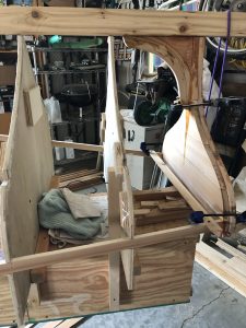

Part 5: Transom Jigsaw Puzzle
Transom/Stern
On the last post we talked about the stem that is part of the bow of the Whitehall rowboat. Today we're going to take a look at how the transom is built for the stern (back) of the boat.
You can see from the picture that the transom is made up of several parts and in two layers. The outside of the transom is what you see above and what you don't see are the alternating layers that make up the inside. The transom is made up of a double thickness of 3/4" boards to end up with an overall thickness of 1 1/2". This is strong enough for a trolling motor to be attached.
The inside and outside layers overlap in a way that no joints line up to eliminate water ingress.

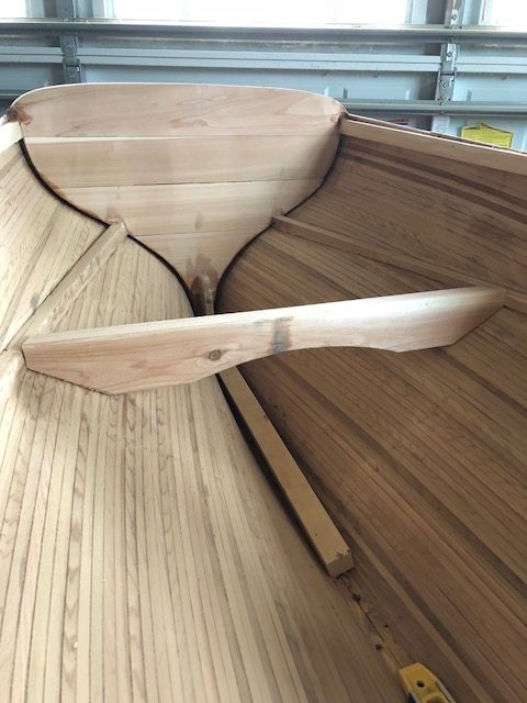

Here we have the transom mounted and it becomes the rear attachment point for the wood strips to come. You can see that according to the plans the transom does not sit right on the strong back like the station molds because the strips will not go all the way to the strong back table top, only to that sheer plank you see clamped to the transom.

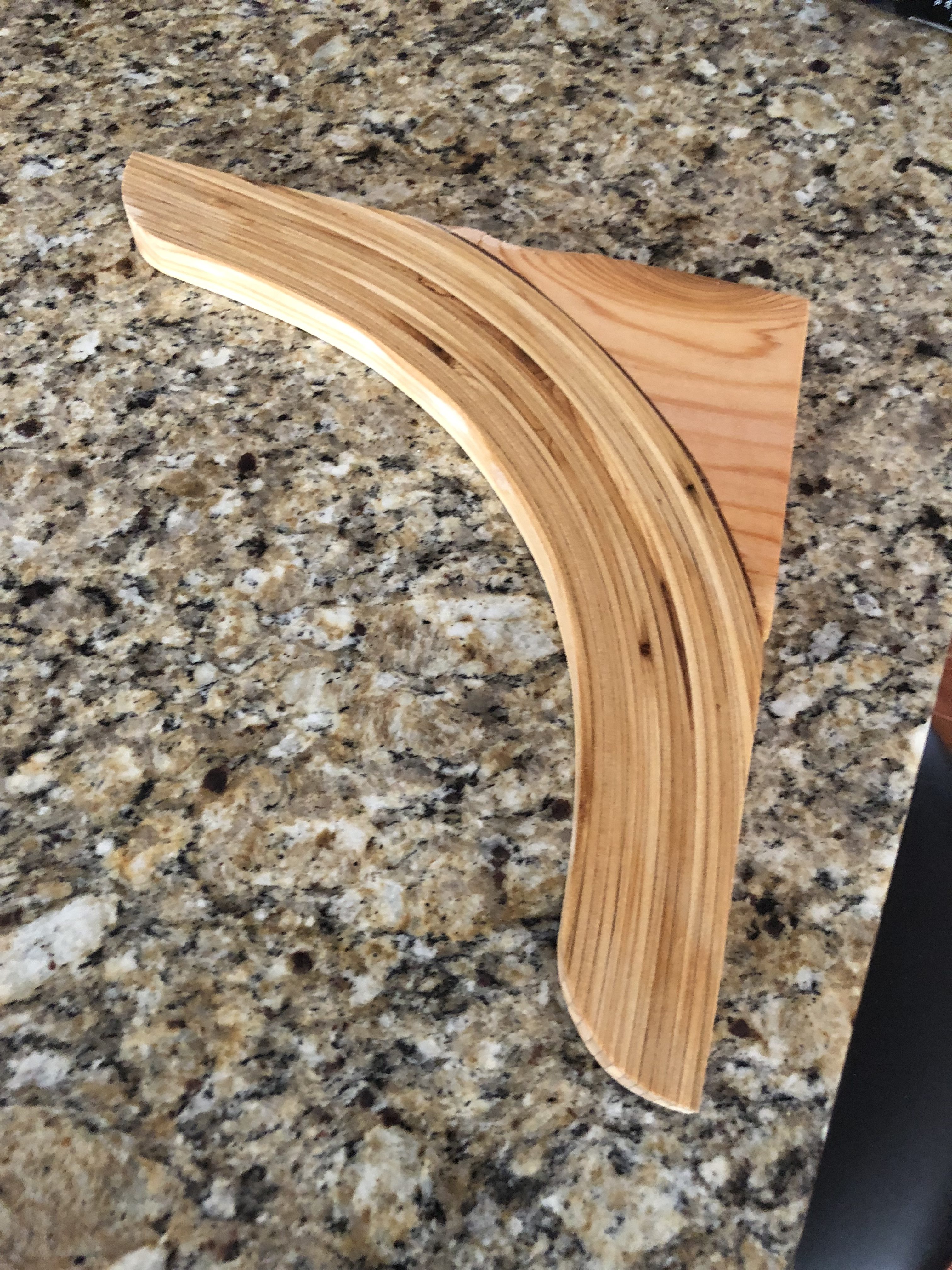

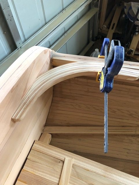

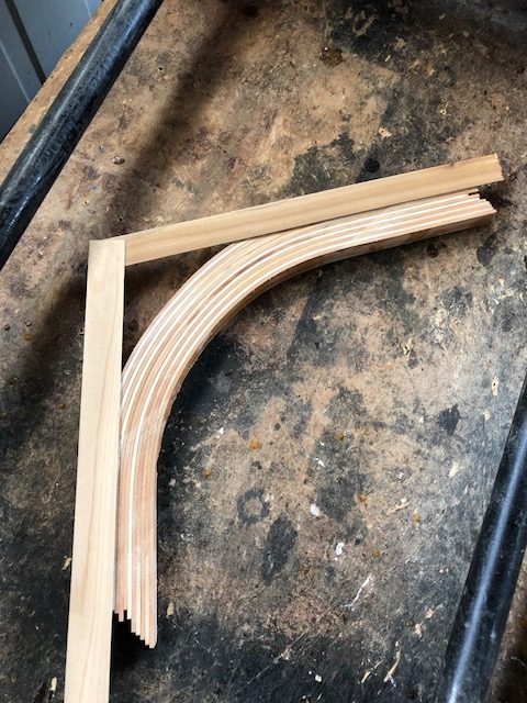

At the bottom of the transom (which is at the top of the picture) you will see that I made another laminated part called a "knee" that connects the transom solidly to the keel.
The finished knee is in the picture above and below you have the laminated strips being held in place on the knee form. The knee form is also part of the plans and I made it from 3/4" plywood to have a thicker surface for clamping

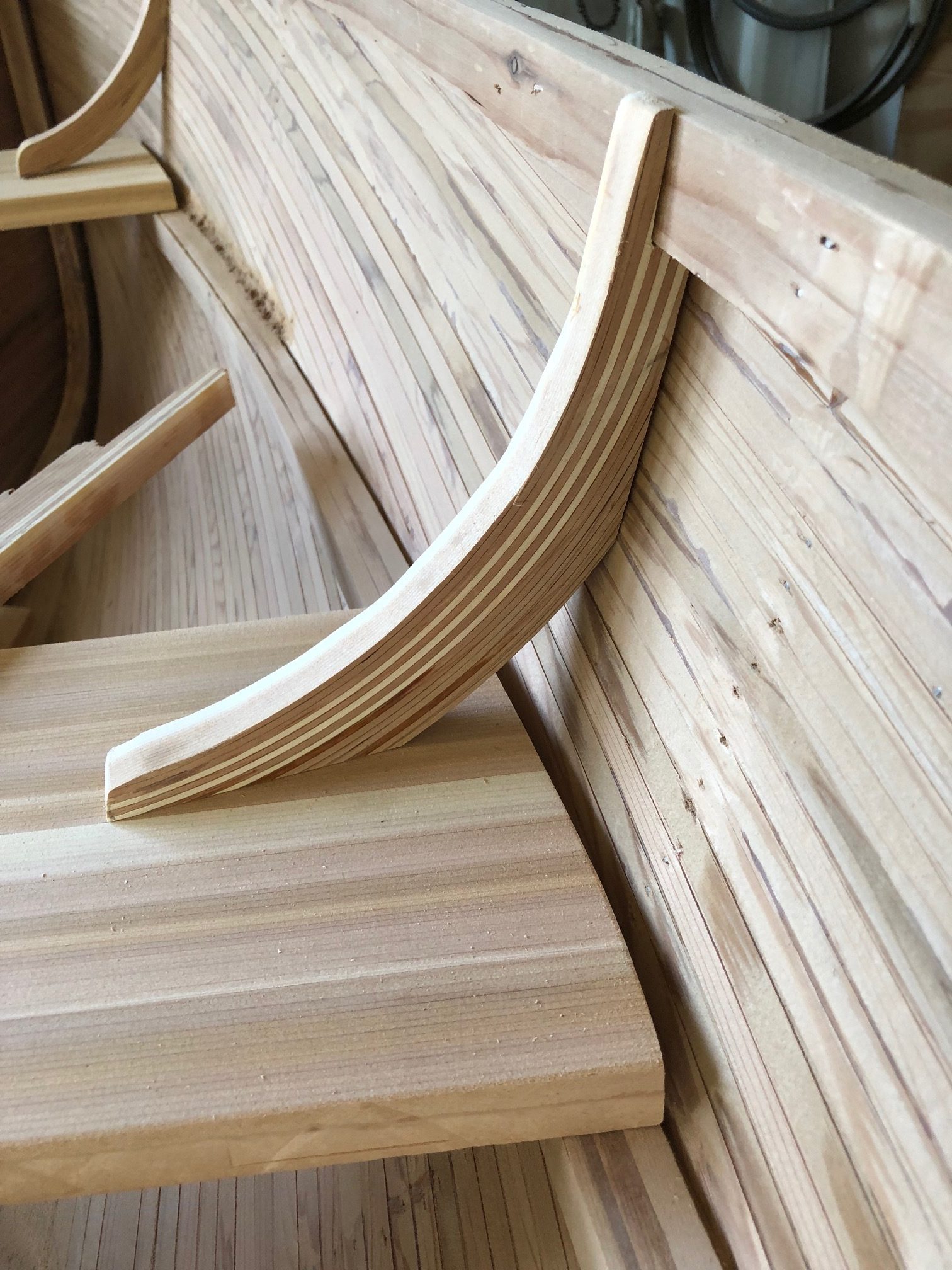

Here is another shot of the transom to keel connection and you can see how the knee helps keep everything lined up properly (it's not a 90 degree angle but don't worry, it's also in the plans) and very nicely screwed and epoxied together.
If you look closely you can also see the layers of wood for the inside of the transom don't match the outside which adds strength.

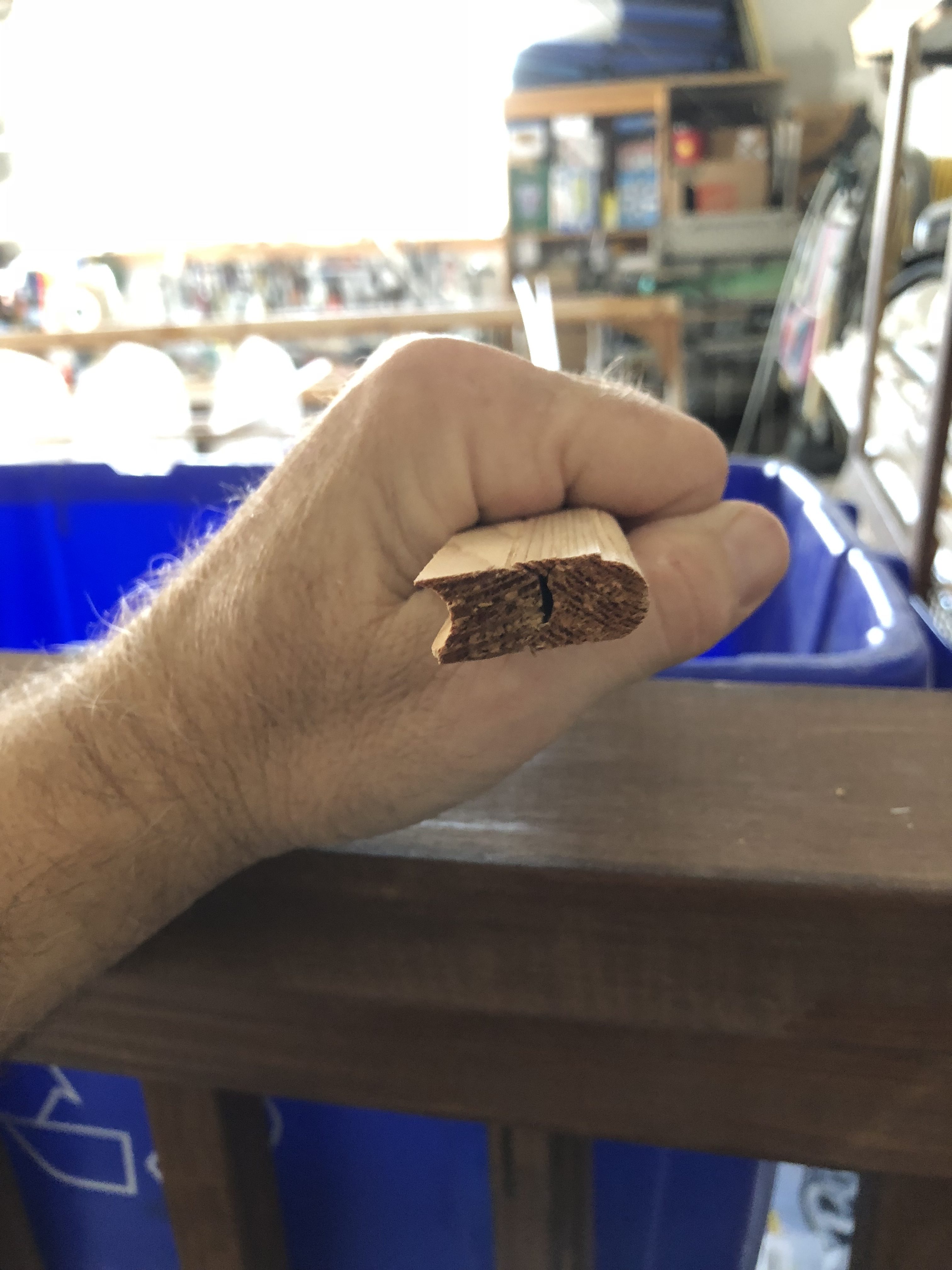

I cut my blanks for the strips a little under 1/2" for thickness and about 5/8" for width (.430" x .620" for my tool & die friends) and all 17 feet long. They were a bit cumbersome to handle but my little rack I made kept them up and out of the way.

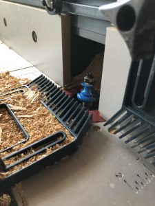

Another must have tool if you're going to cut your own strips is a router and a router table. I received this as a Christmas gift a few years ago because my wife wanted me to make toys for the kids and now I'm finally getting around to using it for my big toy--the boat.
As you can see above I have a router blade that cuts both the bead and the cove into the blanks I previously made however, it doesn't do both at the same time. I have to set it up for the bead and run all the boards then set it up for the cove and run them all again.
The bead and cove strips fit together pretty well and it allows for curving over the station molds as well. The plans call for 1/2" thick strips but I know that my boat will not need as much wood removed through planing and sanding because I'm being careful with the finish on the strips plus it will end up pretty smooth when it's all planked. My strips are about 1/16" thinner than 1/2".

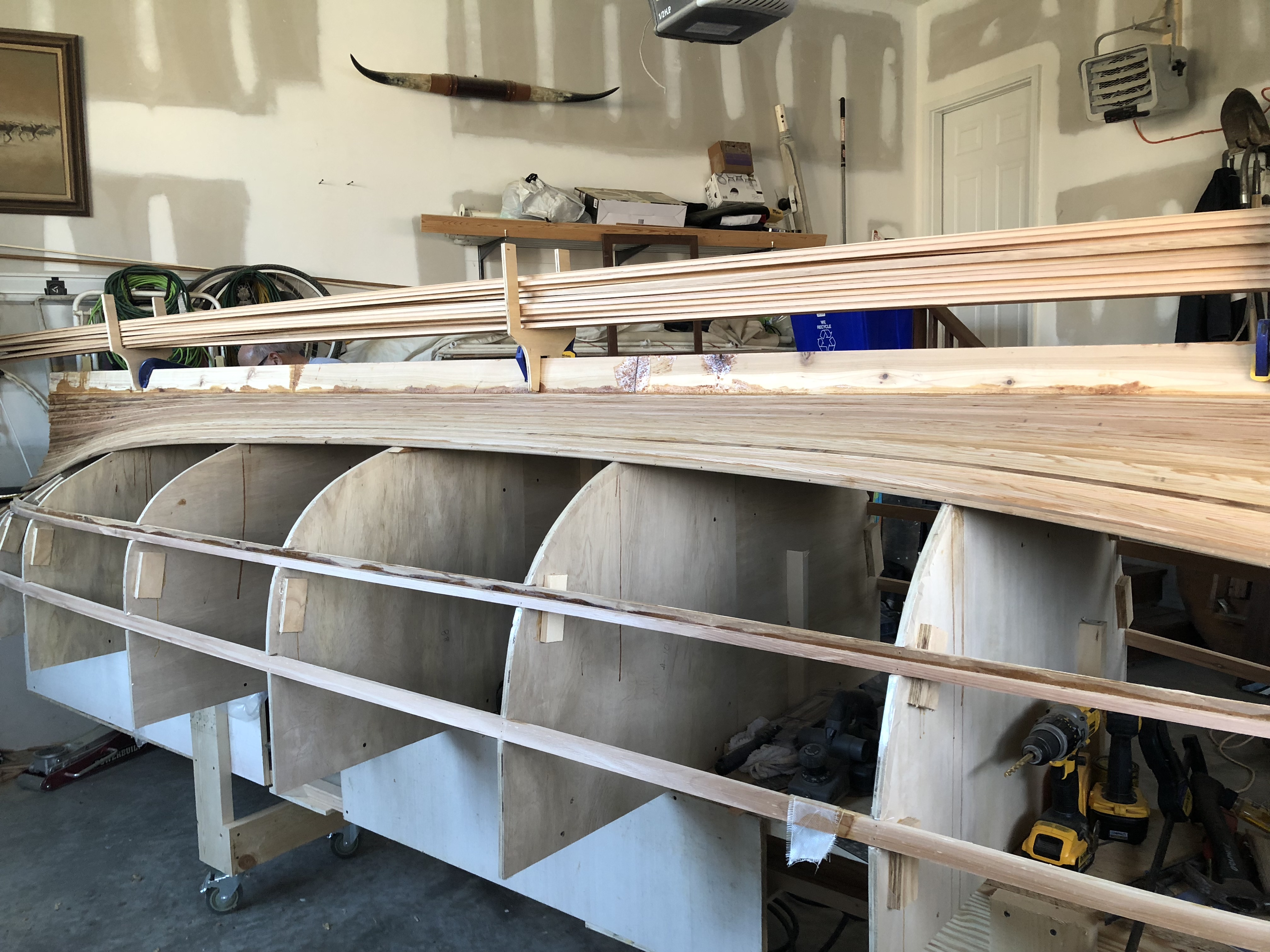

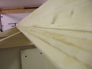

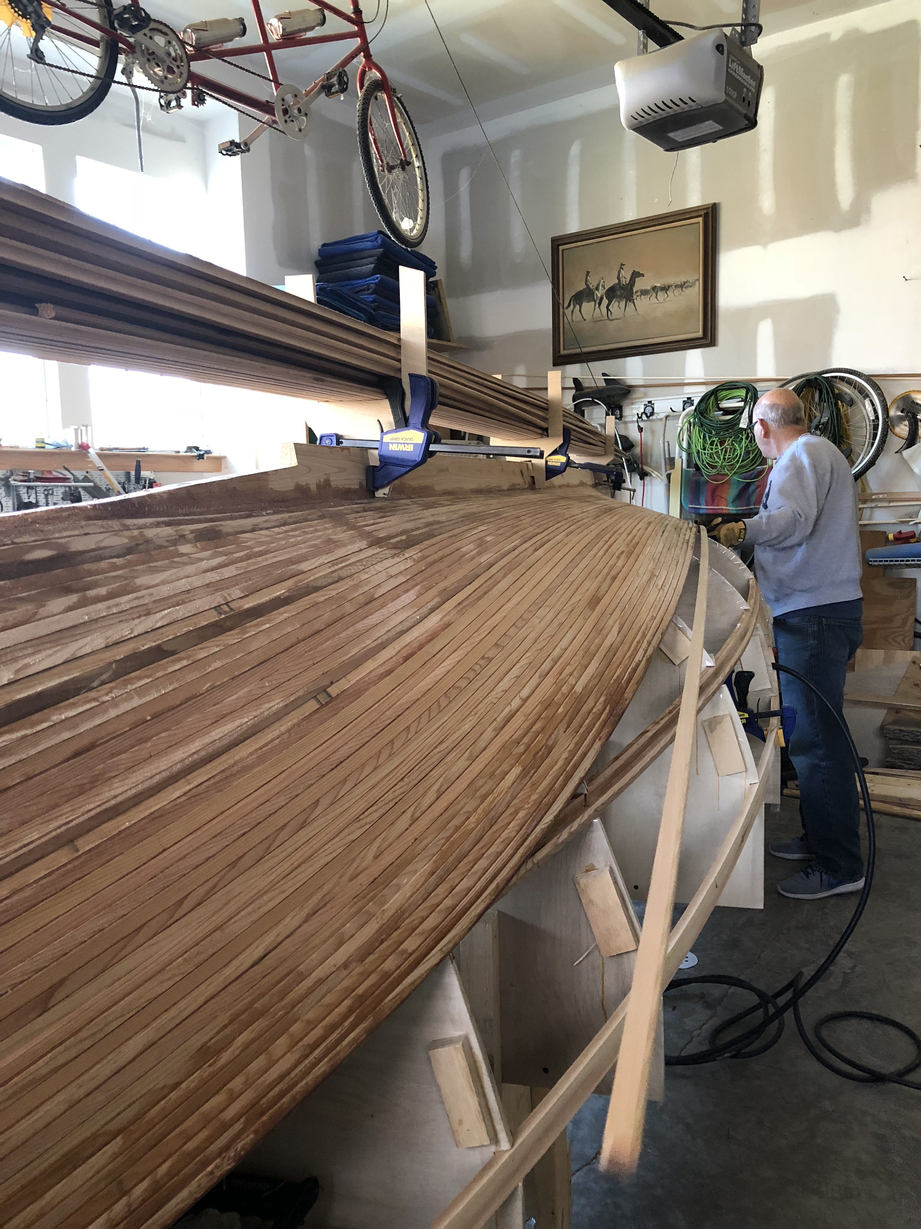

Part 9: Stripping Begins

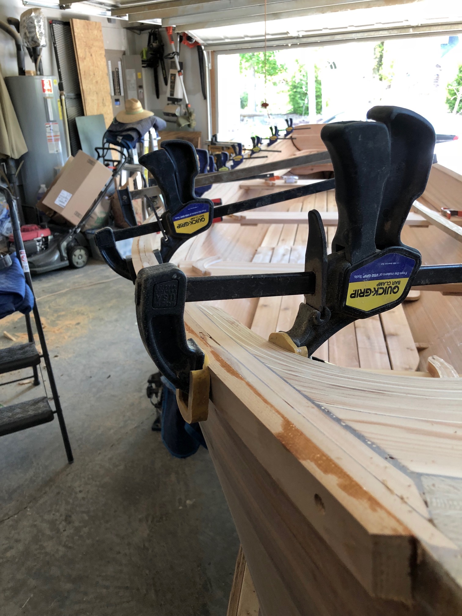

The first strips begin at the keel and though it's difficult to see, the keel has been beveled so the strips make a solid, flat contact and don't just meet at a corner. The first two strips against the keel only had the bead and not the cove so as to make a solid connection. I chose to have the bead down as I added strips so I could tap on the strip with a mallet if necessary without damaging the thin edges of the cove if I had oriented them the other way.
Although the plans call for starting at the keel I've seen others who have chosen to put several rows of straight strips along the sheer and then worked their way up to that point from the keel. It's up to individual taste but this being my first try at building a boat, I'm sticking to the Glen-L plans.

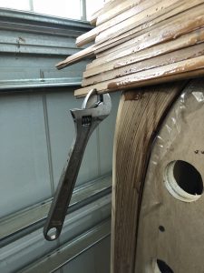

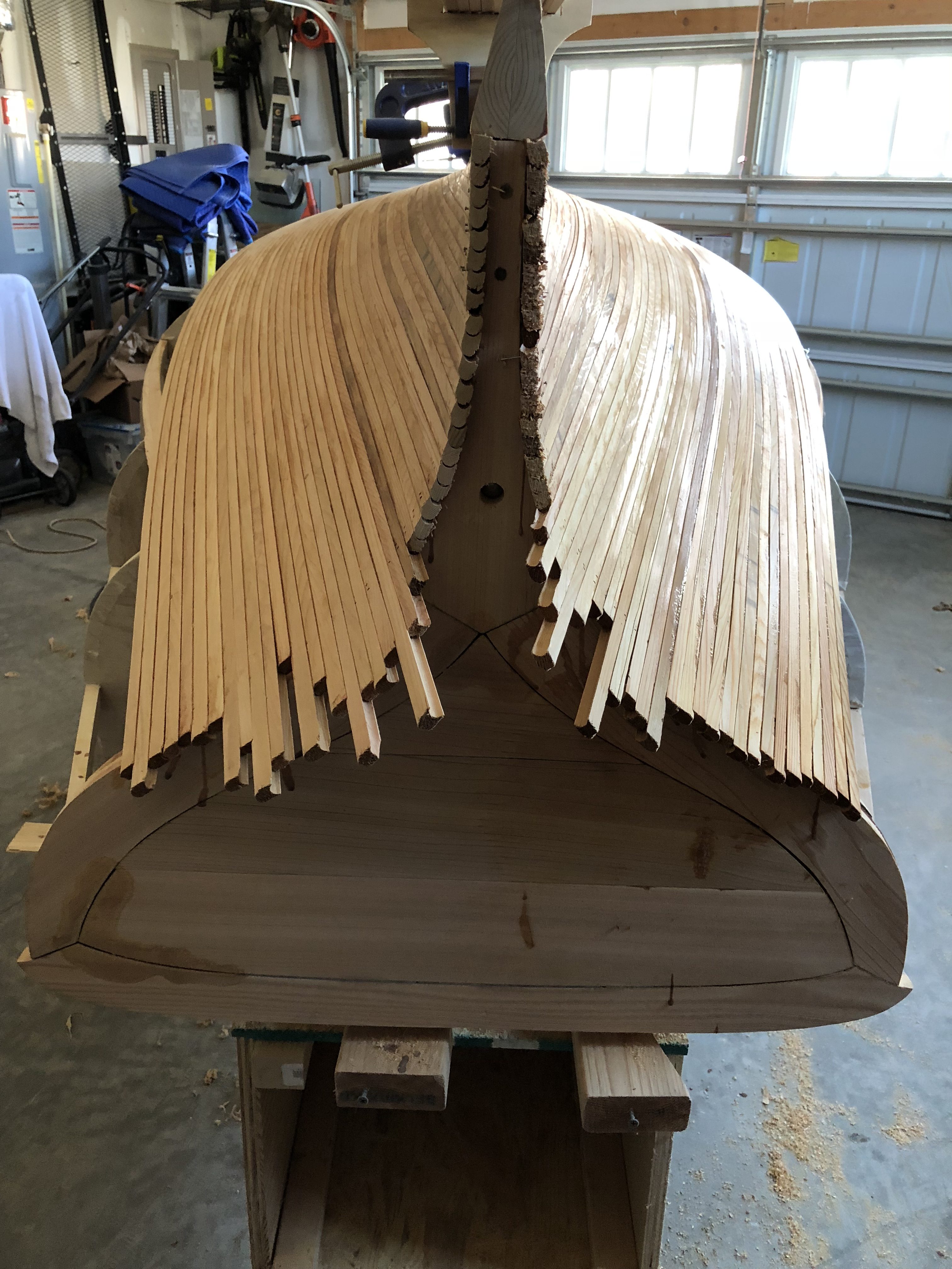

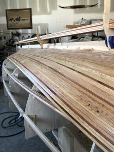

In this picture you'll notice two things. The strips are applied with no concern for them lining up with the end of the stem or the transom at the back. It's much easier to just trim them all later and sand back to an aesthetically pleasing termination. The other thing is the use of an adjustable wrench (crescent wrench) to twist the strips.
Look back at the first photo and see how the strips are nearly parallel with the floor in the middle of the boat and then at this photo where they've twisted nearly 90 degrees to attach to the stem. Using the wrench turns this into an easy operation since you can easily twist the strips into place as you nail them together.
I only needed the wrench for the first rows and once I got about halfway down the sides the bend necessary to attach to the previous strip wasn't so great and could be done by hand.
Each batch of strips was put on the boat by first applying a thin layer of glue all along the previously attached strip then I chose a new strip from the rack and centered it on the middle of the forms making sure that the strip would have sufficient length on each end to cover the stem and transom. I would then attach the strip at the middle of the forms and work my way to the ends of the boat. Each strip has to be tight up against the previous one so a bit of tapping with a rubber mallet was sometimes necessary.

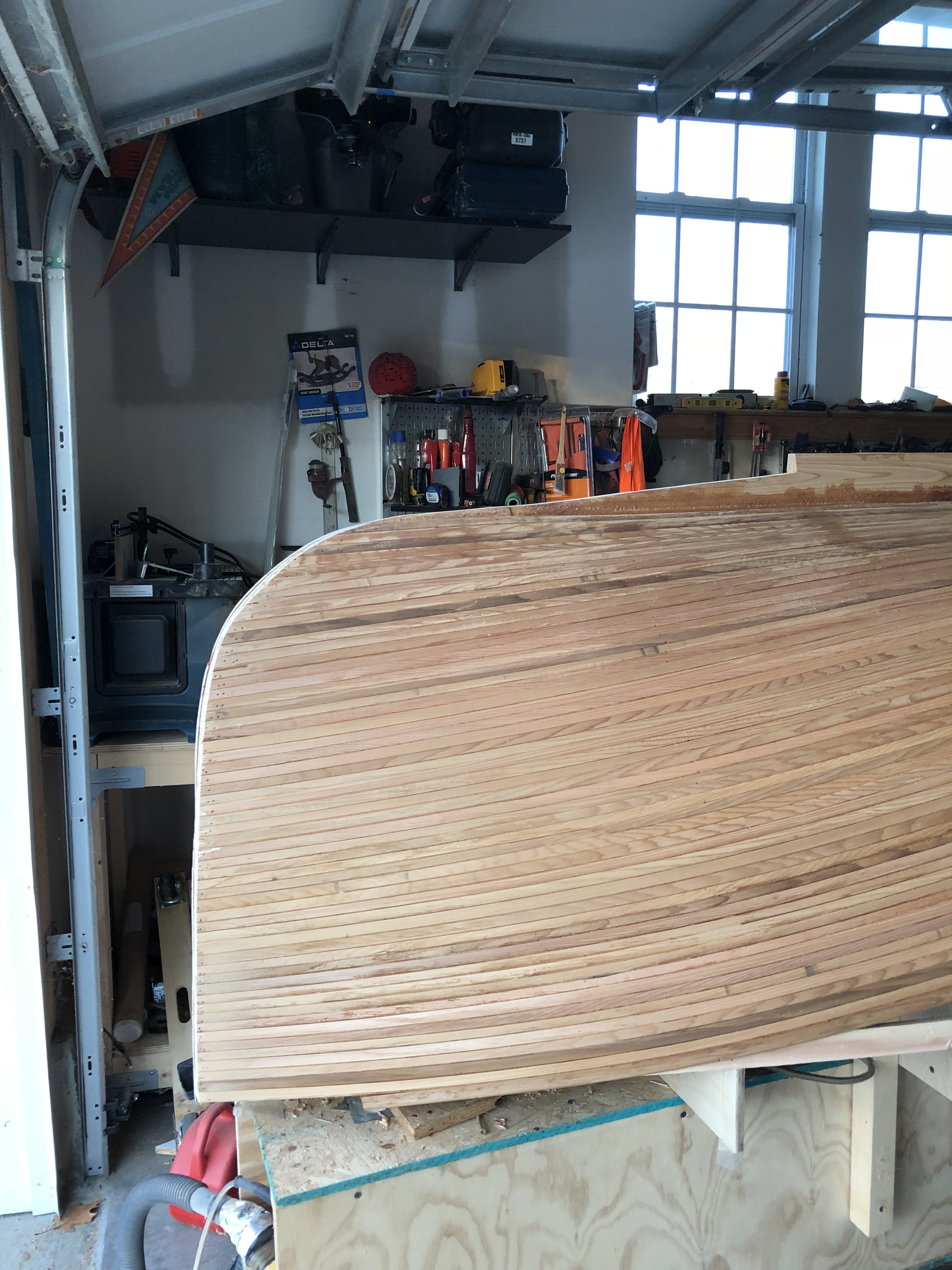

Here's a picture of the stern so you can see how a 17 foot strip just made it to cover a 16 foot boat. This was the closest it got and as I proceeded down to the shear they were plenty long.
At the front I had to trim them as I went because they would otherwise cross the centerline and hit just beyond the stem. I like how the Whitehalls have a nice plumb bow which gives the boat a maximum length at the water line for improved speed through the water.

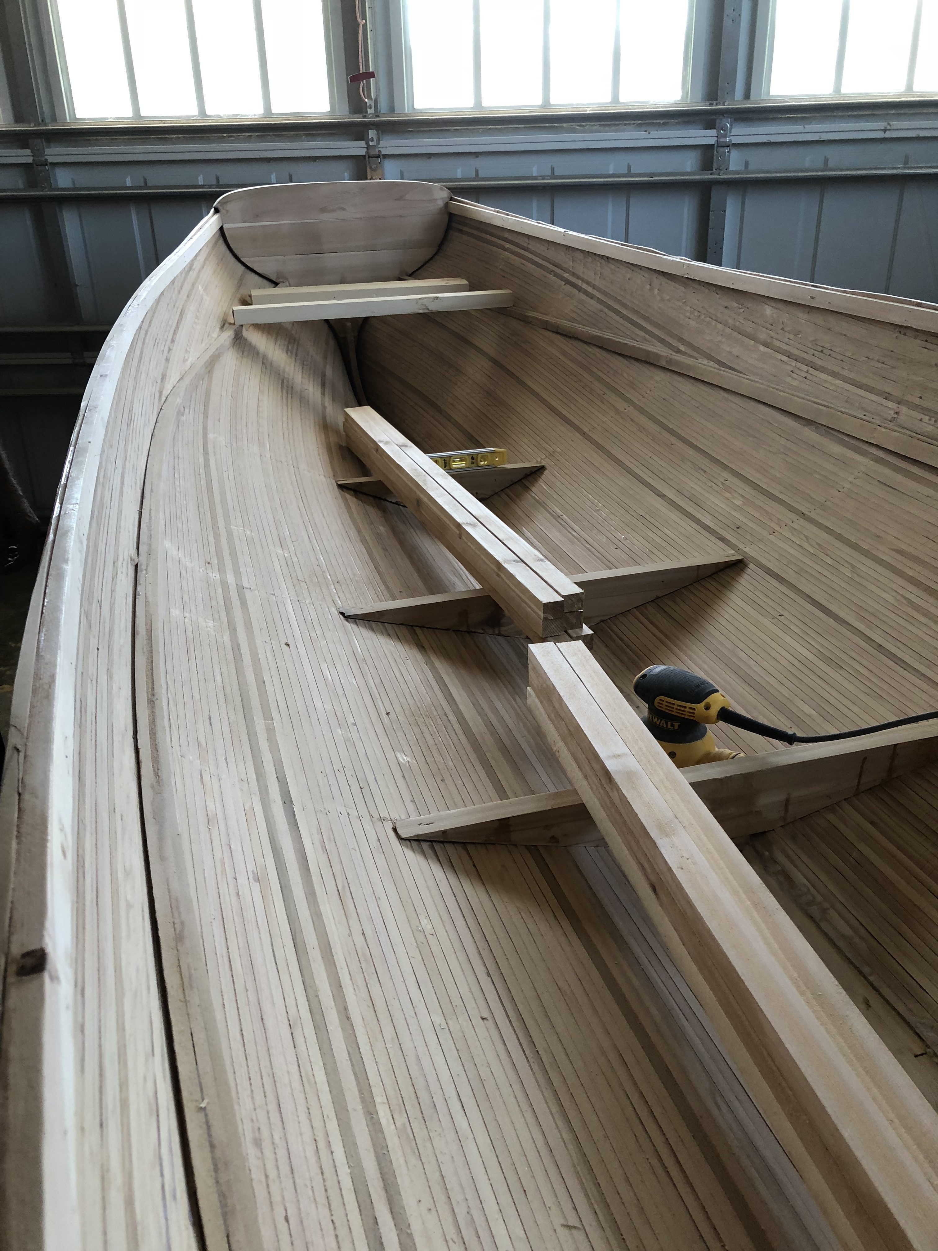

Part 12: Fairing the Hull

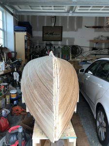

The hull has been completely planked with cedar strips and is ready for fairing which is done with a combination of planing and sanding. As you can see the hull is pretty good already but if you were to run your hand over it at this point you would find a few areas that need fairing.
Here is another view that shows the graceful curve of the hull and a bit of hand planing has been done with a real light run over the hull with an orbital sander. I took care to keep the sander moving and not let the edge of the sandpaper dig in anywhere.
At this point I stood back and took a look at the hull from many angles and made note of places that needed more work.
See that black thing sitting on top of the hull? That's a long sanding block which was very useful for smoothing uneven areas. I put a 60 grit sandpaper on it and carefully sanded diagonally across the strips in both directions until I could no longer feel anything but smooth rowboat. This was the most time consuming part of the job and I spent over a week doing this off and on until my arms would give out then I'd rest and start again.
Once that was done I went back over it with the orbital sander loaded up with 220 grit paper until I had a smooth hull. Check it out below.

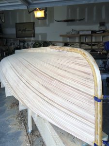

We need to add an outer stem! See that notch in the keel? That's where the outer stem fits against the keel and follows down the inner stem to the top (remember it's upside down) of the boat.

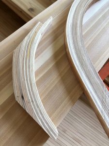

The outer stem, just like the inner stem, is made by laminating strips of cedar and then bending them around a form that matches the inner stem perfectly. In the photo below I set it in place to see how everything lines up and the next step is to use epoxy glue and 1/4" stainless bolts to fasten it permanently to the keel and inner stem.
In the next picture I have the front stem attached and it's been shaped to come almost to a knife edge except that I've left a flat where a half oval brass molding will be added.
I used a countersink to put the stainless bolts slightly below the surface and filled them back in with epoxy mixed with wood flour. Wood flour (from sanding the hull) was mixed with epoxy until it was about the consistency of peanut butter and filled in the holes. I also used some of the epoxy/wood flour to fill in a few low spots and faired it back later.

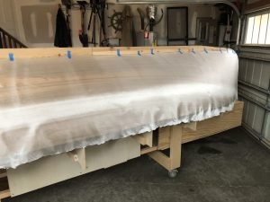

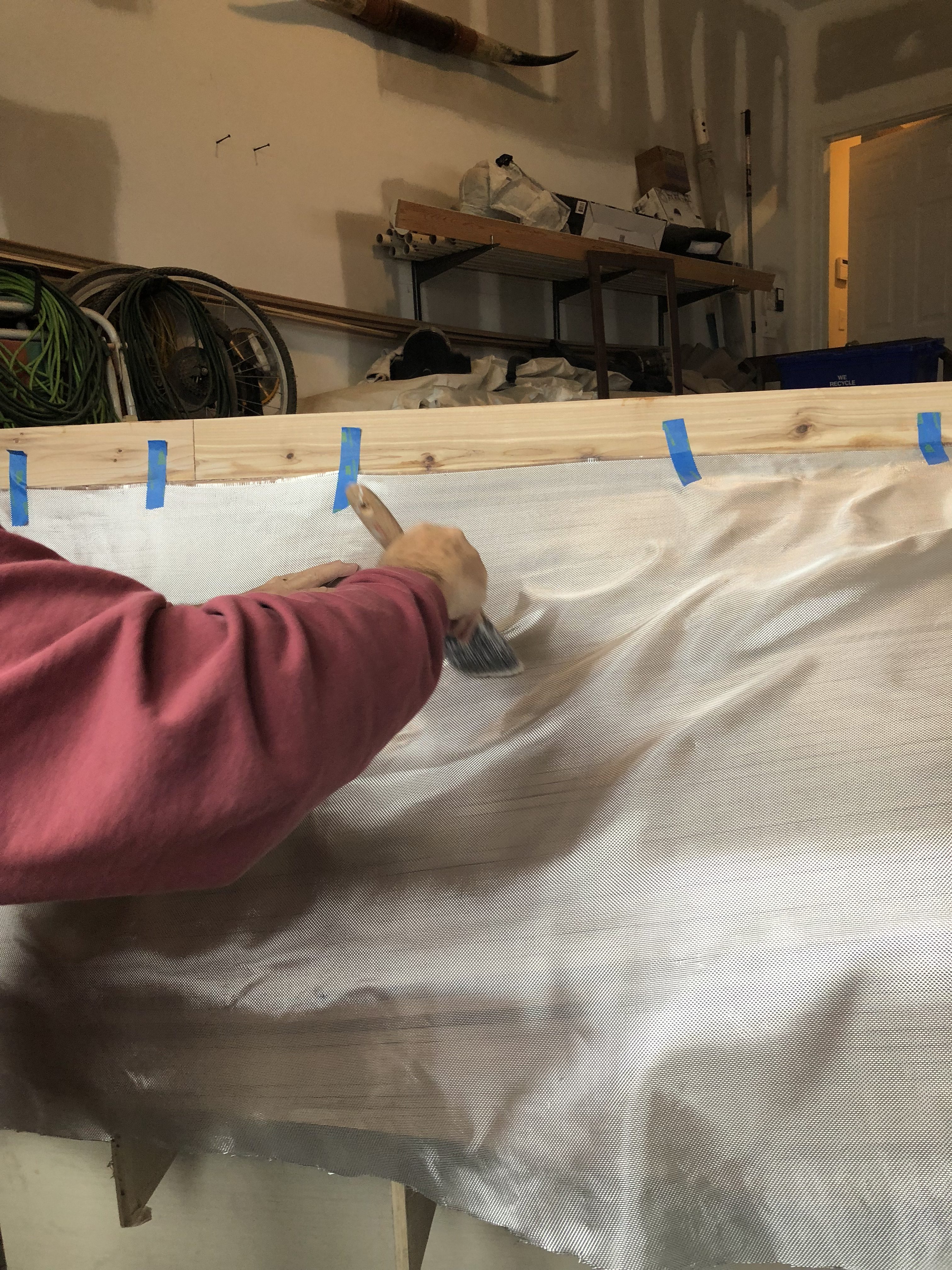

The cloth comes in a big roll and it will have a few wrinkles as it is spread onto the boat so it will need to be brushed smooth as you see in the next photo.
It's a mess at first but eventually with enough brushing it will get like this below.
Sometimes you will have a hard wrinkle in the cloth but you can usually get them to go away by using a circular motion on the weave. BTW, the first picture at the top of the page is after the brushing is done and the cloth has been allowed to sit overnight.
I had originally planned to lay the cloth over the keel but after doing some research on other builds that's not the best way to go. There is a lot of tugging on the cloth once it's in place with resin on it and the cloth ends up pulling away from that right angle where the keel meets up with the planking. The only way to eliminate that problem is to fiberglass the planking first and then go back and do the keel second.
Tomorrow I will start gluing it down with a layer of epoxy resin. It's best to put the epoxy on when it's not too cool out and with low humidity which is not a problem for me because I have a heater in my garage.

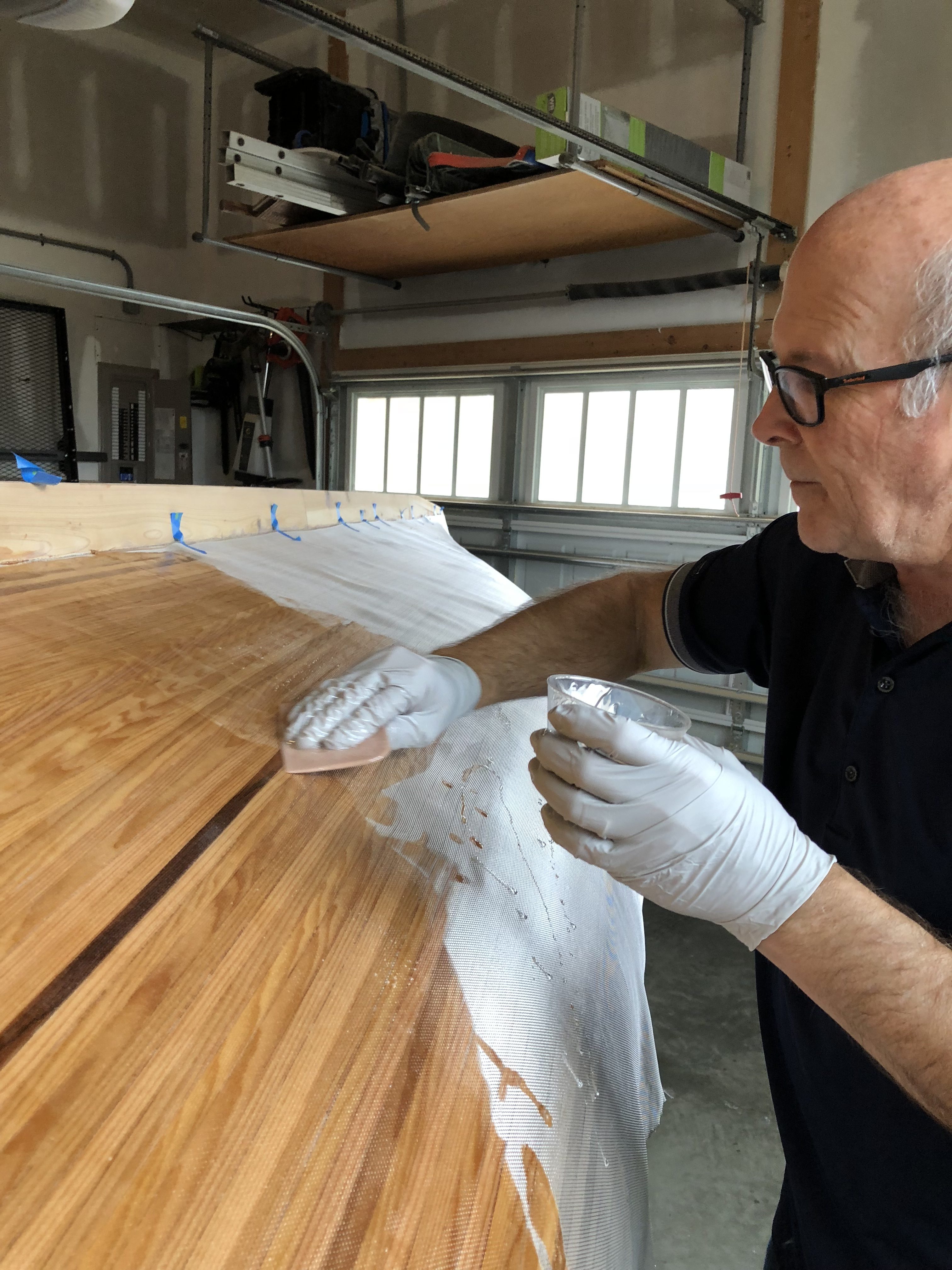

Part 15: Applying Epoxy Resin to the Cloth
Since it will require a fairly good quantity of resin, a project like this will have to be done in small batches that are applied quickly. I was hesitant to dive into this part of the build but here goes...
Epoxy is a two part system consisting of the resin and a hardener. The length of time it takes to set up can be extended by using a slow hardener so that is the route I took.
The "pot life" or amount of time you can work with the resin depends on the temperature in the work area plus the hardener you use. Even with a heater in my garage the temperature was hovering around 65 degrees while I was doing this and with the slow hardener I could easily mix and spread a cup of epoxy onto the glass cloth saturating a section then moving on to the next before the previous area had started to set up.
In this way I was able to do one side of the boat in about thirty minutes by pouring on a little epoxy then, by using a plastic spreader, I would move it around until I had an even coat and the cloth disappeared.

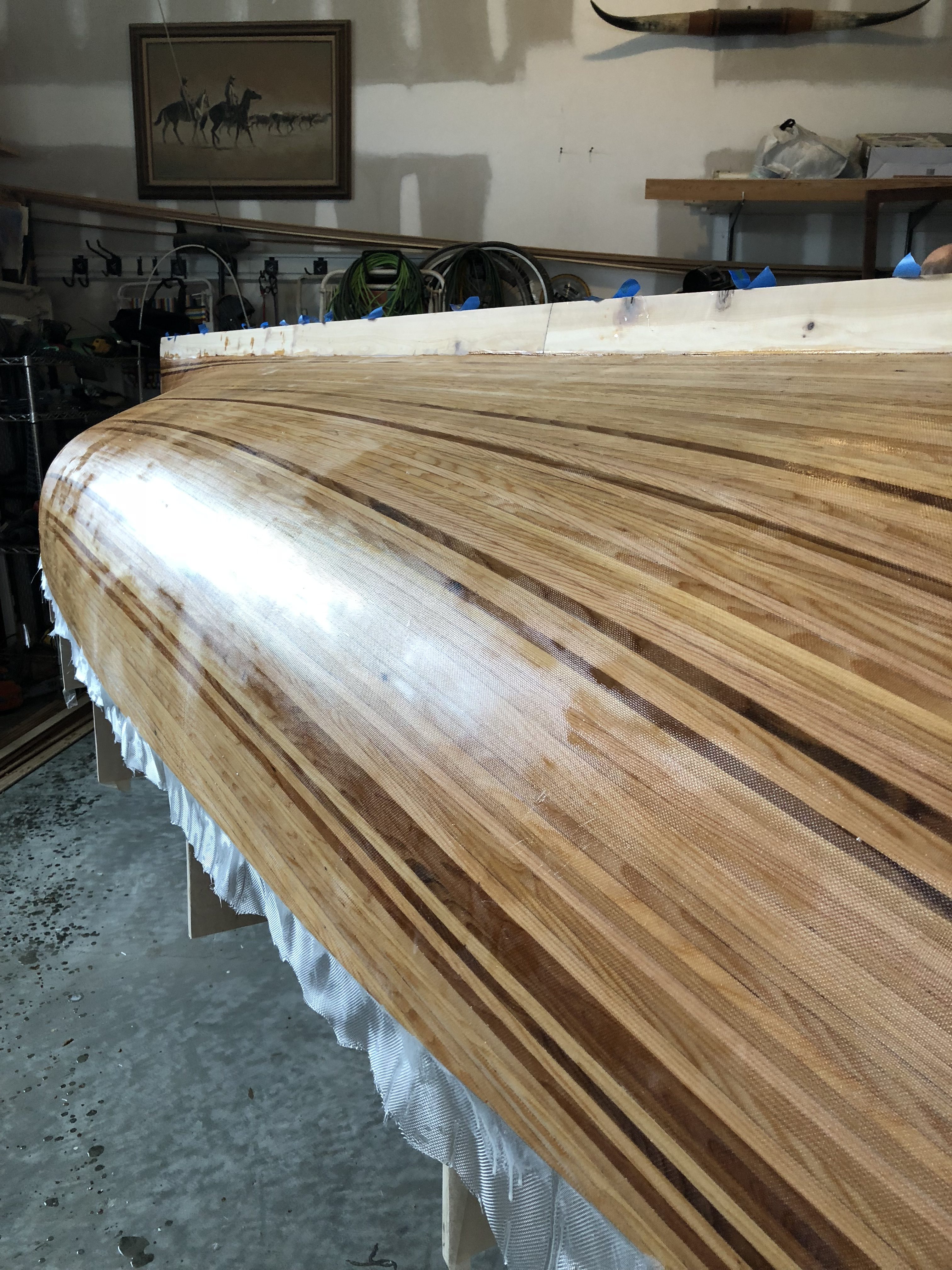

In this picture you can see how the nearly opaque fiberglass becomes transparent as the cloth is saturated with resin. However, after one coat the weave of the cloth will still be visible so you will need a few more coats. Try to keep it smooth and even while minding the way the cloth is getting pushed around.
Here's how it looked after one coat and you can see I chose to leave the cloth a little oversized and trimmed it back later.
The Whitehall is beginning to shine after two coats of resin and the weave of the cloth is nearly gone.
Here we are after four coats of resin. Between coats, the resin needs to cure enough so that the surface is not too tacky but not so dry that you need to sand again. If you apply the next coat before it dries completely you will achieve a chemical bond but if it becomes too hard then you must sand and go with a physical bond. I was able to get a chemical bond between all coats.

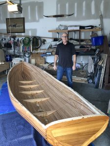

Part 16: Getting Ready for Varnish
We need a coat of Varnish!
After two weeks of curing the Whitehall has four coats of epoxy over fiberglass cloth and is looking pretty good but it's not finished yet. Even though the weave of the glass cloth was almost gone after two coats there is a reason why we continued to add the additional two coats of epoxy, the surface was not ready for varnish and will need some attention before we can get a nice glossy finish.
The slow hardener combined with the cool temperatures sure helped to maintain a wet edge as I applied one batch of epoxy after another but it also meant I would have some runs to fix.
That's where this handy tool comes in.
This is a cabinet maker's tool called a scraper and it's made from spring steel. It comes with a very sharp edge that can be used to scrape off runs without damaging the flat surface. In a very short time I had all the runs removed from the boat. Here is a picture of the boat after scraping it.
It's looking pretty rough after scraping and with some sanding the surface will become dull again but smooth!

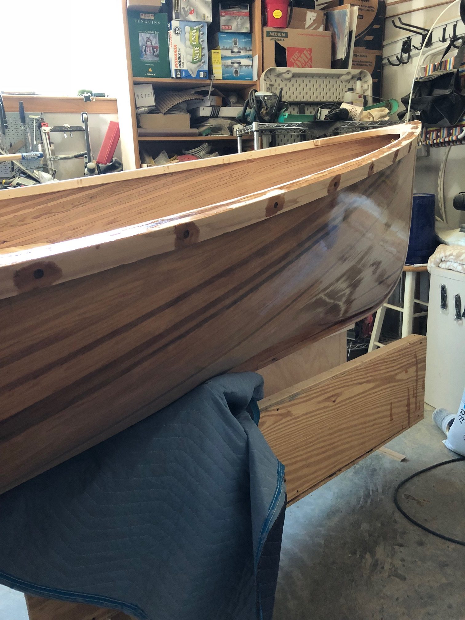

Before sanding the hull I washed it in the driveway with soap and water to start with a clean surface. Then I rolled it back into the garage and spent the next few days sanding the hull smooth with 120 grit paper then switched to 220 and finally wet sanded out in the driveway again with 320.
We are now ready to varnish!

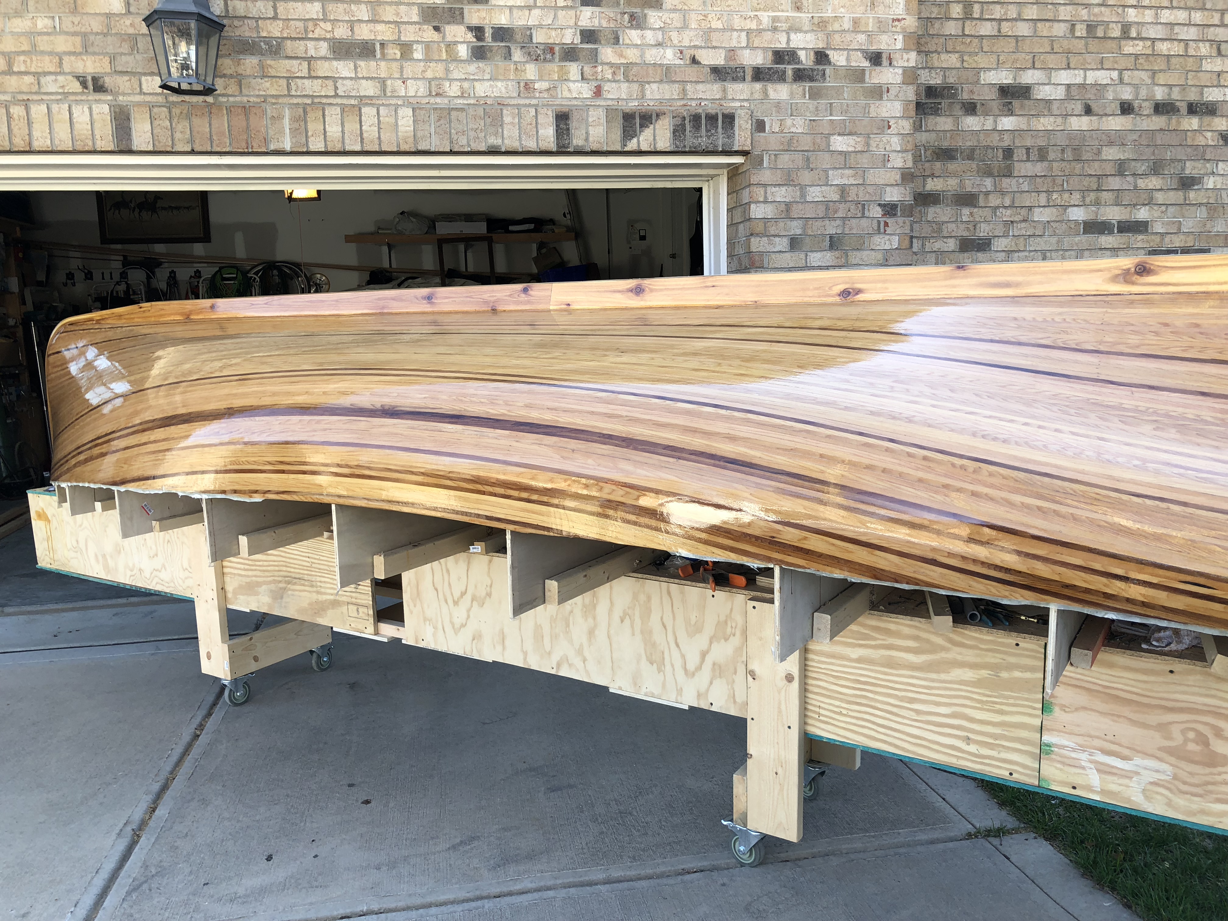

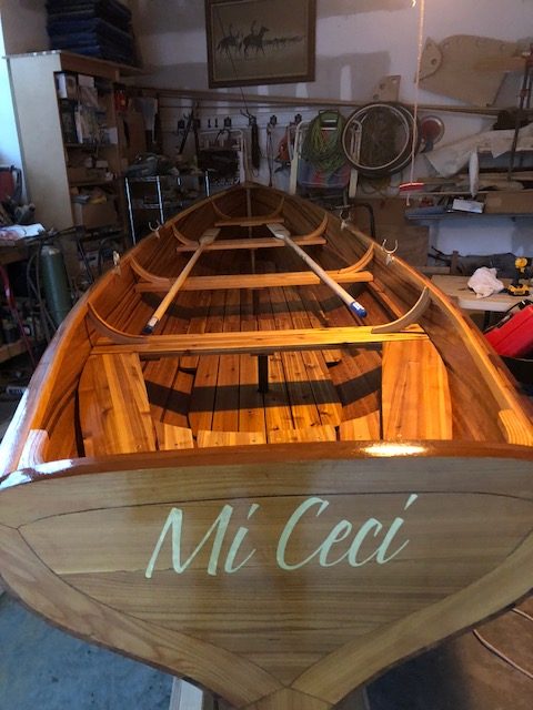

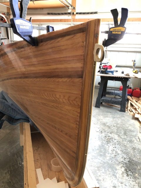

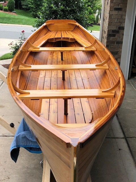

Part 17: Varnish!
The day before varnishing I washed it out in the driveway to give it one last check to see if there were any areas that needed attention and everything looked good.
After a couple coats of varnish the shine started coming back. I let it cure for a day and lightly sanded by hand between each coat. I used a foam roller to apply a thin coat of varnish and then after a section was covered I tipped it with an almost dry brush to smooth it out. This method works pretty well.
It has been said that, "A man once drank a quart of varnish. He had a terrible end but a beautiful FINISH!!"
After all that scraping and sanding it was a relief to see the shine come back better than ever and now the epoxy layers underneath will be protected from UV rays.
Time to flip it over and get to work on the interior!
Part 18: Off the Mold
Today I removed all the screws holding the molds to the strong back and my son and I lifted the boat off and set it down on some moving blankets. The picture above is after the mold halves have been removed and as you can see, it was necessary to use a hammer to get everything out of the interior. (Leave the floorboard supports of course).
I had to remove the top of the strong back and made some supports for the bottom of the boat by utilizing the forms obtained from the full sized Glen-L plans. I found the corresponding mold station forms and traced them onto new 3/4" plywood then cut them out to leave a cavity that the boat would rest on perfectly. I added a moving blanket to make sure that nothing gets scratched.
Now I'm ready to start on the interior.
Part 19: Interior Planning
Now that the boat is upright it's time to figure out the interior. We will need four thwarts, (which will be the seats), a rear bench, a bow breasthook, ten knees and floorboards.
My plan is to fabricate and fit into place temporarily, every part I need for the interior on this boat. Once that is done I will take it all apart and finish each part individually and have them ready like a kit. This should result in a nice looking interior.
I decided to use laminated thwarts and in the picture above you can see some of the cedar boards cut for the four seats. After I cleared out the leftover debris from the destroyed station molds I was happy to see that the interior surface of the boat was pretty smooth already and would only need minimal sanding.
The breasthook and the knees are made using the form patterns in the Glen-L plans but you will need to custom fit them to the contours of your boat. In order to eliminate a lot of trial and error cutting I made some templates from the work by taking a few scraps of wood, setting them in place with a drop of glue at the joint and letting it dry.
In the next post we'll see how the breasthook and knees are made.
Part 20: Knees

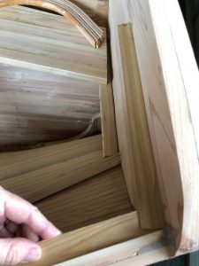

In a previous post I showed how the knees are laminated and today I'll show how I shaped them to custom fit my boat.
As I mentioned in a previous post, I made some templates from the boat itself so I could eliminate a lot of trial and error cutting and sanding. In the picture above I've got my template on top of one of the knee laminations to get it ready to trim for the boat.
Here is the stern knee clamped in place to check for fit. I don't want to finish it yet until after I have the stern bench finished and can get my wife to sit there and make sure it's comfortable.
In the pic above you can see what the thwart knee looks like after first using a template to get the general shape then trial and error fitting. Once I had one that fit perfectly I used it to quickly make its duplicate for the other side.
Here's how it looks mocked in place. By the way, I made the knees out of red cedar and I tried to alternate the colors so that I got this striped effect. I hope it looks good once it's epoxied and varnished!

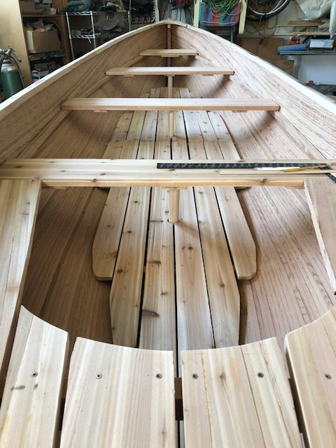

Part 21: Rear Bench and Thwarts
The rear bench starts with a support for the front of the seat and a brace will also need to be added between the risers at the stern. I used the Glen-L full size drawings for the station mold closest to that brace to get the correct contour for the hull. I took the lid from a barbecue and traced the radius onto the bottom of the brace to give it a little style.
The bench needed several laminated parts that would end up being cut into a "fan" shape to make up the stern bench for my Whitehall. I started with cedar blocks cut and planed smooth then clamped them together utilizing pipe clamps until the glue dried.
I ended up with several pieces like the one above. I placed one of these on two bricks then jumped on it to test it for strength. GOOD!

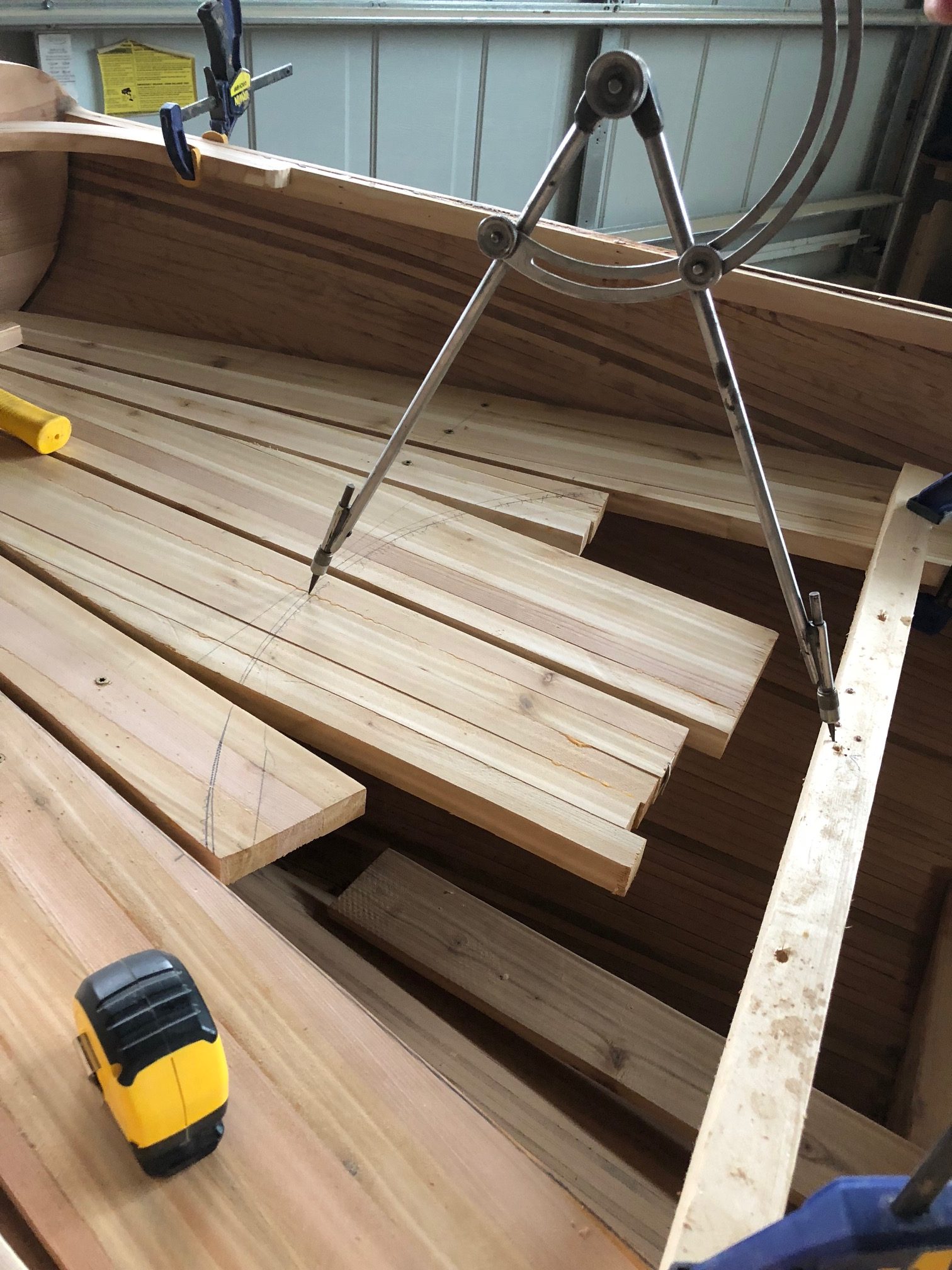

The stern bench has a large radius cut into the seat and I made that by temporarily attaching the seat planks before scribing a large radius using a divider I found in an antique shop.
After I cut the radius I asked my wife to sit in the boat to make sure it's comfortable. She said it felt great and I was impressed with how strong this boat is. I was expecting to hear a few noises from the boat since the stern bench was cantilevered out from where the boat was being supported but there was nothing. There was not a squeak or a groan and it didn't budge a fraction of an inch. This design is SOLID!
In this picture you can see the way the seats will look. It's starting to look like a boat!
And as you can see I've already started on the floorboards.

The rub rail runs along the length of the boat from stem to stern on the outside of the planking and along with the inner sheer, sandwiches the planking to make a nice sturdy rail.
I was hesitant to dive into this part of the job because the rail was a fairly stiff piece of wood. It not only needed to follow the curve of the boat but also had to start high at the bow then dip to the middle and then curve back up again to the stern. However, with enough clamps, anything can be done!
I made a test fit by clamping the rails to the boat then I marked the ends for cuts plus made an alignment mark in the middle so I could easily duplicate the placement again. Once my cuts were made I roughed up the area where it would glue to the hull and applied a layer of epoxy and clamped it up again.
Once it was back in place with glue, I drilled a pilot hole every six inches and put a countersink on each hole. Then I screwed through to the planking and inner shear for a nice tight fit. The next day I mixed up another batch of epoxy with cedar wood flour until it was the consistency of peanut butter (but looked more like Fig Newton filling) and filled all the holes flush with the rail.
I also added a bronze bow eye for the painter line by drilling through the stem and bolting it on from the back side. Check it out below.

Part 25: Finished
I named it after my wife.
Here it is rolled outside to get a look at it. I'll post some pics of it in the water next week.
