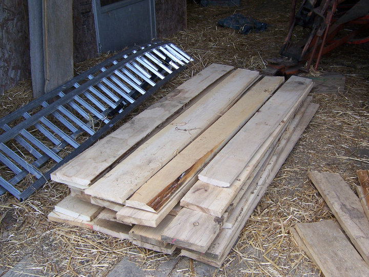

dragging 16 foot hickory boards that I had seasoning for 10 year out of the barn - jun 2010
cutting ruff ends off cutting to smaller lengths to transport
the results of all the cutting I did

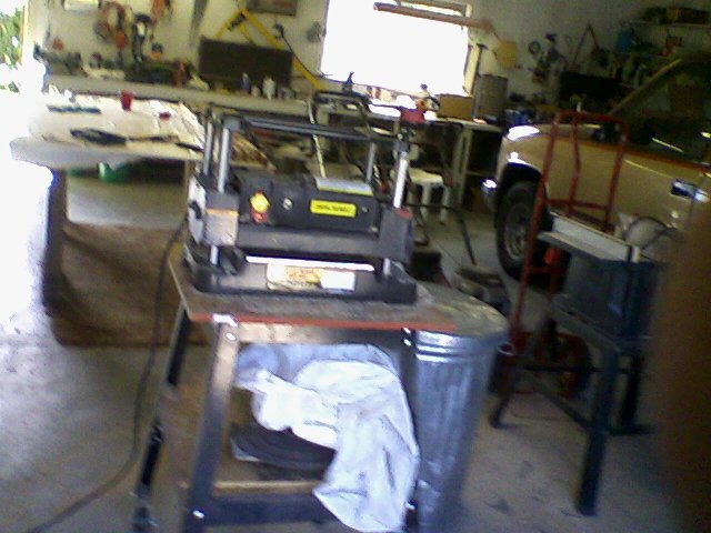

my cheap thickness planer but it does a better job than the industrial I used in collage go figure

My prints came in for my house boat and went out and bought a new thickness planer to use on the build also have line on a table saw it's heck replacing equipment

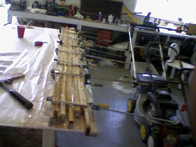

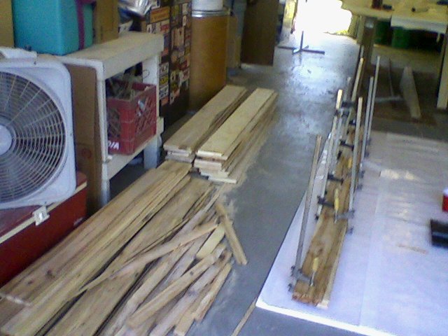

Started planing my wood of my frames my epoxy came in and have been gathering construction material
making smaller pieces into bigger pieces then planing them down to thickness

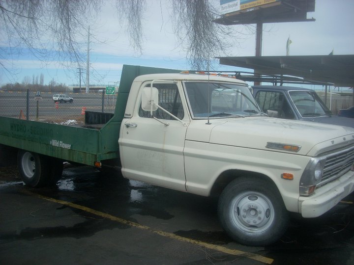

Started building the boat but it is a long process, I also picked up our towing vehicle a 1968 ford f350 with a 390 v-8 with 5th wheel and tow kit and the trailer breaking system.
tow truck 1 ton f350 with 390 4 speed duel wheel
Progress is slow going due to lumber size, I have to epoxy up small pieces to larger sizes from my lumber I brought back from Ohio is only 5' long and it needs to be over 7 foot so I am doing this by using Scarf Joints and staggering the joints on the lame beams I am making

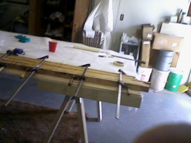

epoxying up a beam to be used at bottom of bulkhead frame- Aug 2010

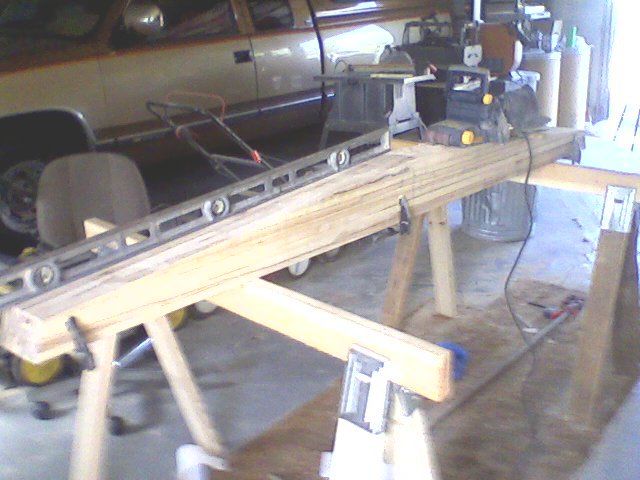

Finished cutting out 4 of the five bottom frame/bulkhead pieces are pretty much the same in dimensions. I am in the process of truing them up so there are no drips or ridges in them. I am using a belt sander to do this with and a straight edge making sure the dimensions are the same to all of them. I clamped them together so when I do one the others get done as well
Truing up the bottom pieces using route, plane and belt sander notice the straight edge to make sure everything is true
