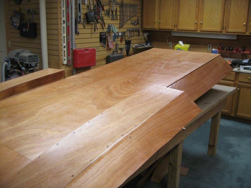

I finished up the bottom as far as resin coating and we flipped the boat earlier this week. The coamings were fitted and the bow was faired where the bottom planking overhung the bow ring. Today I rough cut the decking and routered the fit along the carlings. Then I encapsulated the aft section of the boat. Tomorrow I will install the aft sections of the decking and install the coamings and the rest of the forward framing and strongback. The reason for installing the aft deck sections before the coamings is to prevent the coamings from springing the carlings out of their natural bend. The aft deck sections will provide the ridigity needed to keep everything in shape.
I went with maranti hydrotek for the deck. WHAT CRAP!!! See photo below.
