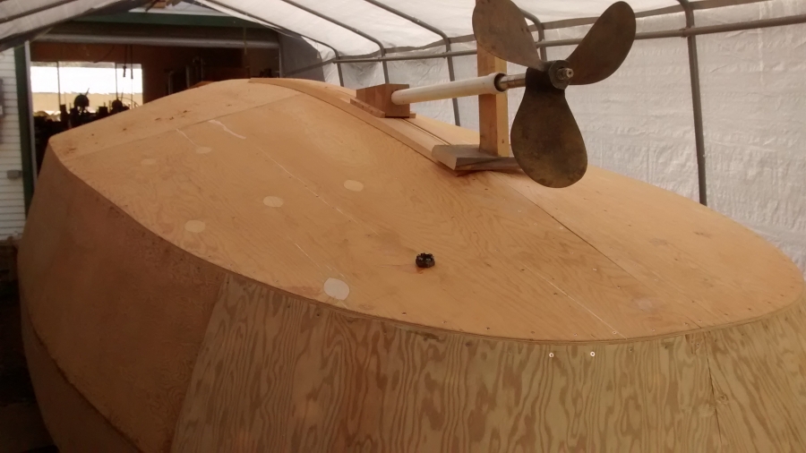

November 2017 - Engine mounts, Shaft tube, Stern Bearing
A really nice piece of 2x8, thats actual dimension even after planing, is used as the outer support. The mounts were leveled to the DWL and notches cut into the mount to fit over the frames. One of the exercises was to level and jack the hull solid while on the trailer. Other projects that were added to was the shaft tube, the stern bearing, engine flushing, engine installation and preliminary alignment.
Shaft tube - is a piece of 2" schedule 80 pvc with a threaded coupling to the stern bearing. Shaft is 1⅜ stainless. Clearance to shaft tube is 1/16". A 2" threaded coupling is glued in, and the stern bearing will be threaded into the coupling forming a watertight connection.

July-August 2016 - Keel build; drill shaft log
The bottom of the lower board is the center line of the shaft. Two cant strips were cut to produce a flat and horizontal surface and secured to the keel. The stern portion of the strips were fairly easy, but the angle of the hull quickly changes in the forward area so these needed to the secured first then leveled after. The shaft angle to the hull is 15°. A jig was constructed to guide a 2" drill into the keel. Additional blocking was placed on the inside to give the drill bit guide something to drill into and keep it straight. The guide was secured to the keel and the shaft hole drilled. To check everything out before things go too much astray, a shaft tube and the shaft was put in place and measurements confirmed.
The main part of the keel was laid up plank at a time and drilled, angle checked. 7 layers were completed along with a 4x6 stern bearing block. Four threaded rods were placed on the front and back of the bearing block. The remainder of the keel was completed with a total of 17 layers plus a 2x4" timber running the full length containing the keel bolts every 2 feet. This took time, glue and lots of screws, basically one layer every 2 to 3 days after preping the plank, gluing and screwing the plank in place (it's curved, so took a lot to pull a 1" piece of fir down tight). Took until mid September to complete the keel, by which time, the temperature was perfect to begin the fiberglass on the outside. 1 layer glass and 3 coats of resin finished by mid October.

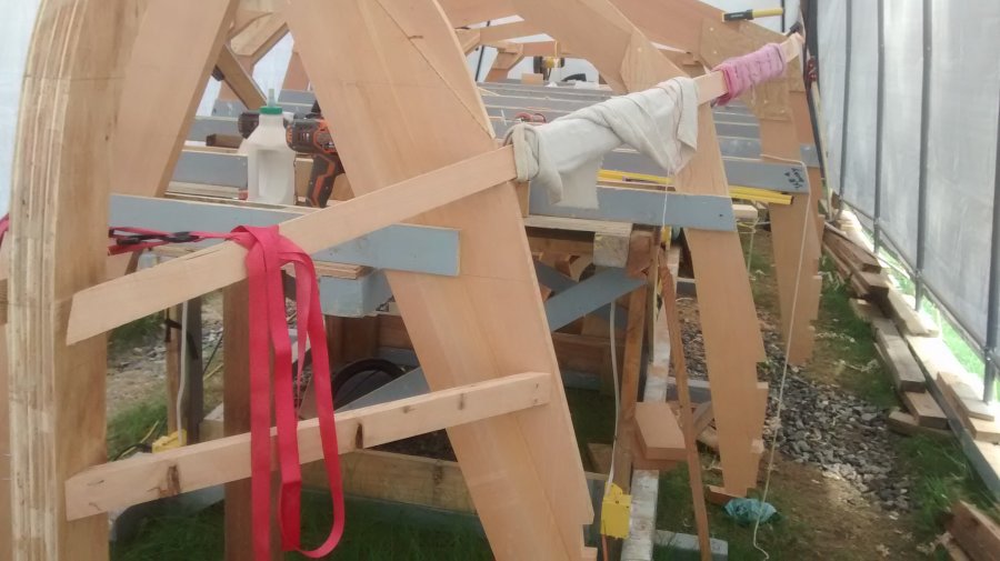

March 2015 Frames
The frame construction is well under way. Each frame's assembly was a wee bit different than the previous as I learn how to assemble the frame and glue things together in sequence and keep my hands somewhat clean while doing so. Temperature running around 10°C, so not too much in a hurry to do things until after lunch. The construction frame is working great for putting the frames together. A sheet of flooring underlay is perfect as a layout board.
For the layout, make sure that you have the DWL and the CL EXACTLY in the correct position on the board. It makes life really easy to double check the position of the key points on each frame. The coloured pencils are perfect for figuring out what line is what on the board. I lay the pattern I did on the butcher paper out on the underlay, drive a small finishing nail through the key points of the frame, identify the points on the underlay, join the points with coloured pencils, lay the frame members out on the underlay and start the assembly knowing that all the members are symmetrical, and in the correct position without damaging the drawings with glue. A piece of wax paper under the frame member joints works great by keeping the glue from bonding to the underlay.

It's the end of the month now, and I have all the frames complete. I realized that the building form will have to also be a scaffold so I can put the keel and battens in and fair the keel. I've installed a couple of sheets of 3/4 ply on top of the building frame so I can stand on it while doing the work. Nice thing about the plywood; it's square and checked by building frame squareness. Still have to do the stem and stern posts, so there is still time to use the building frame as a work table. I'll run a line down the middle of the plywood for the frame alignment. Can't think of any particular reason why this could be a disaster looking for a place to happen: beats standing on air while working the keel and the battens.
Picture here shows the plywood on the building frame with the frames in position for the keel and logs, but that's getting ahead of myself at this point. Just wanted to see how it would work out. Most valuable tools for this part of the project - thickness planer, jointer, 14" band saw with 3/8 blade, belt sander, cordless drill and impact screwdriver. Based on Doug H's experience with his boat, I've redone the arc on the bottom frame to increase the radius and get a better fit with the plywood. At the least, I'll have lots of wood to do the fairing.
