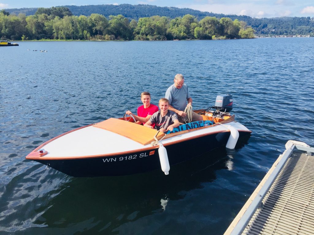

I am creating this blog post as a sort of record of the build process of my Glen-L Tuffy, named Pluto. I'll go through some of the major details and show some pictures as well.
I bought the Tuffy plans in July 2015, at the end of my freshman year of college. I had wanted to build a boat for many years, and this was the point when I finally thought I had the know-how and money to do it. Although the Tuffy is quite a small boat at around 13 feet long, it was the perfect design for my limited amount of garage space and experience. The build took a very long time because I was working on it while also working on a degree in Aerospace Engineering in California. I could not make regular progress so I was limited to putting in hours whenever I was back home in Washington for breaks. Pluto first hit the water in September of 2017, but wasn't really finished until around March of 2019. And there are some last things I am still working on.

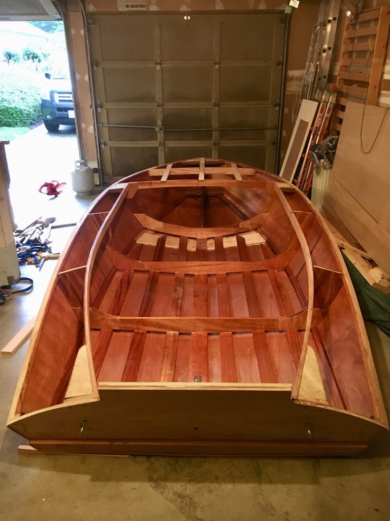

It was during the early stages of the build that I learned to use many of the tools that I was not yet familiar with. The structure of the boat is made of African Mahogany and White Oak with Okoume plywood planking. Although none of this early work was especially difficult, I found it time consuming because I had never done woodworking on this level before. There were many tricks I still had to learn.
