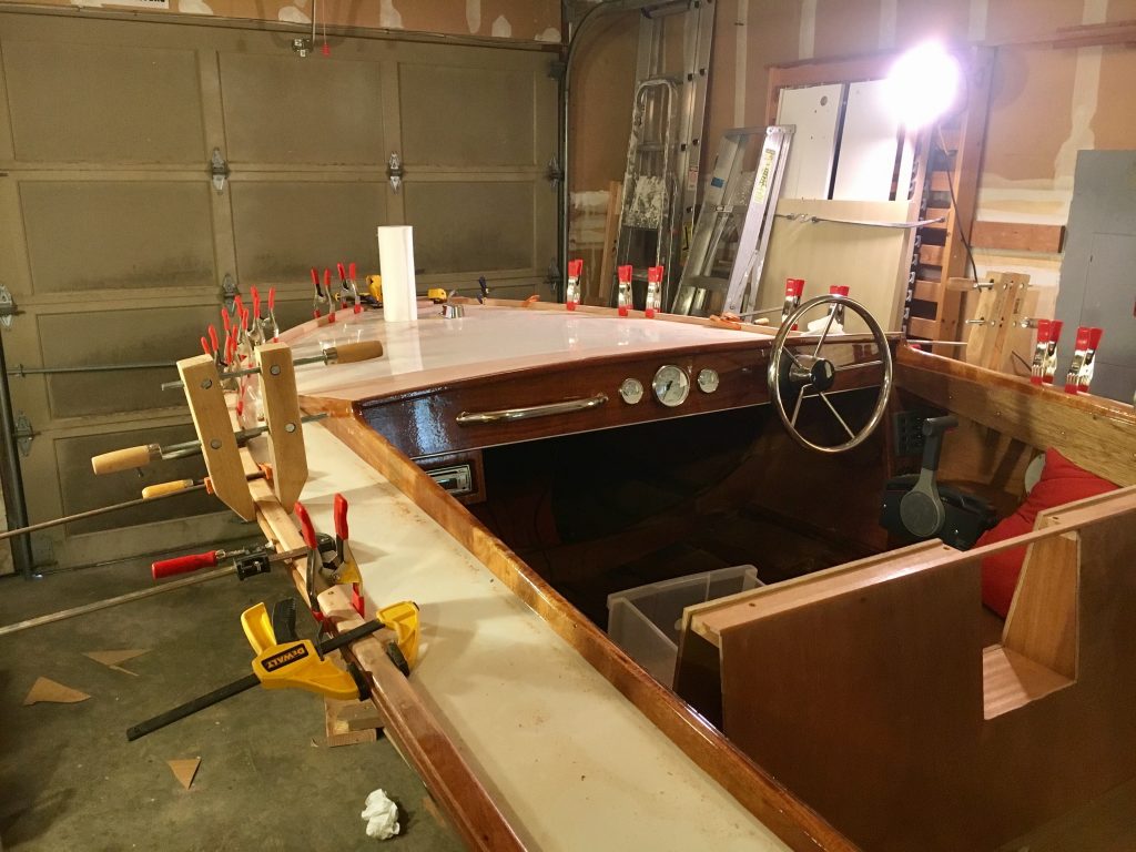

The rest of the build was focused on the deck and interior of the boat. The deck was sanded, primed using Interlux Epoxy Primekote and painted in the same way as the hull. Then a toe rail and rub strip was mounted on the perimeter of the deck. The rub strip can be removed fairly easily in case it is damaged.
